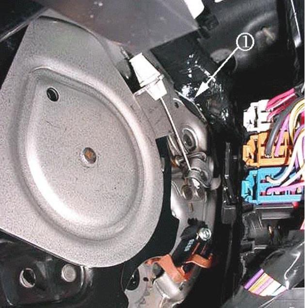

I have had this issue several times, usually while driving. I will be driving, sometimes at highway speeds and sometimes at residential speeds and without warning, my gauge cluster will "turn off" and "turn on", as in the gauges will drop as if the truck is off then come right back on to where they should be given the driving circumstance. The door locks will lock and unlock over and over. If I shut the truck off while this is occurring and try to start the truck back up, it makes no attempt to even crank as if the battery were dead. After waiting a few minutes, go to try and start the truck again and it starts right up only leaving the radio clock and date reset and the air controls reset to 74° on both driver and passenger controls.
I have also experienced the issue while trying to start the truck. I will attempt to start the truck and get a no crank, turn the key back and then try again and will start. Again, clock/date and air controls reset.

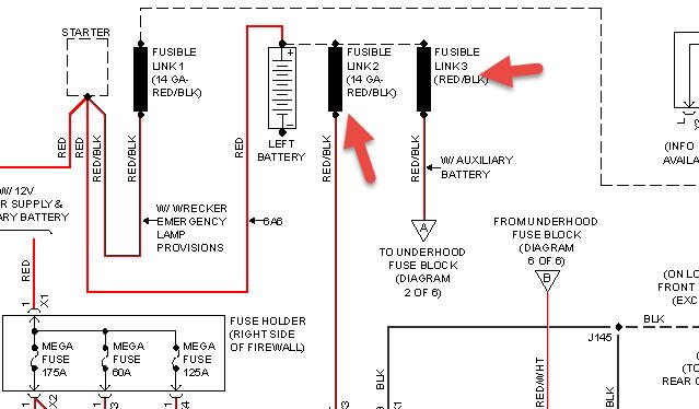

I've seen multiple comments/posts about the 175A fuse needing replaced because it will end up arcing, but there are no signs of arcing in my case.
I can't recall for sure, but I would imagine that when I took my truck to the dealer and told them the issue and informed them ahead of time that there are multiple TSBs of the issue, that they would have gone through and checked the fuse and toequed it to the proper specs, as well as checked battery cables and connections and looked for corrosion.

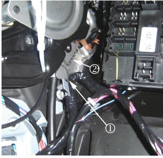

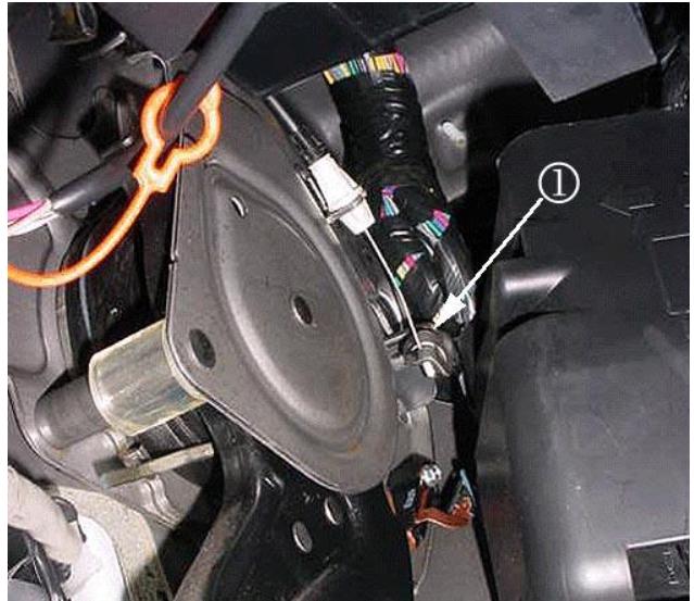

I can't say wha the dealer has or has not done, but from having worked in dealers 15 yrs things haven'tchanged much and they don't eget paid much to look at a tsb. If you happen touse your parking brake that area may be the problem because the tsb's I've read mostly are for improper installation of aftermarket parts. The harness near parking brake which I have pic of where to check as well as those neat little devices the progressive insurance likes to have you plug in to your aldl that screw up the electronics in the vehicle. So if you have one take it out and see if anything changes without seeing this vehicle in action or for any mechanic for that matter it h as to do it while in their possession otherwise you will get answers like we give. We are not machines we are human and relate on our experience and other little things we have picked up through the years. So check the areas where the pics are showing and check fuse 46 underhood for corrosion an dthe fusible links in pic wiggle them around and see if theywill repeat your problem theymay have a strand broken or two just hanging on and causing the problem. I have nothing further to add.

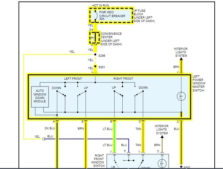

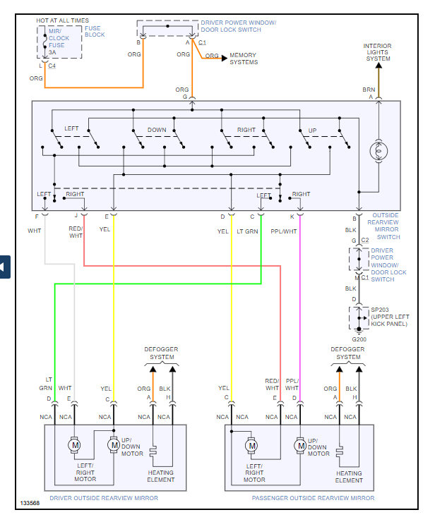

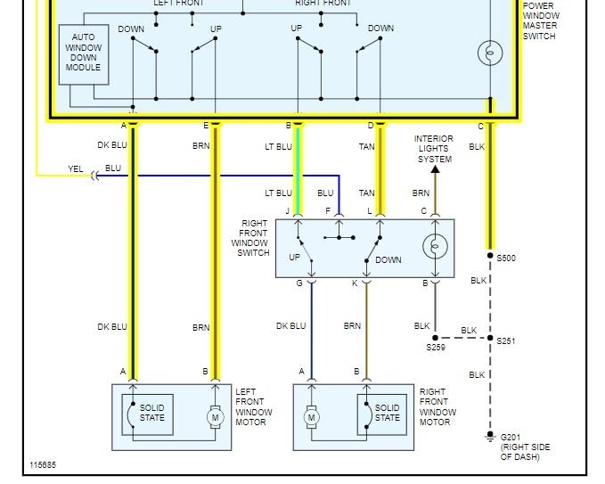

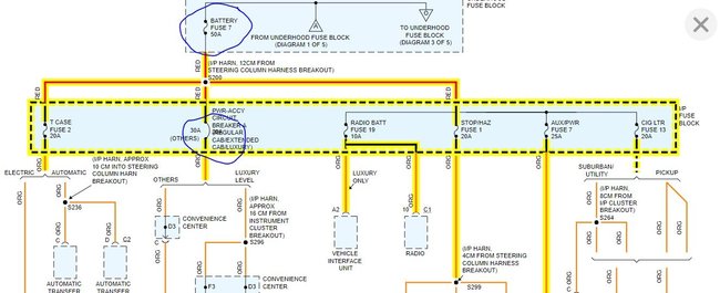

I have power windows and locks on my Sierra. Sometimes when the ignition is on, the windows do not roll up or down. The small lights on the door panel go out indicating there is no power to the switches. However, when the ignition is in the acc. Position, the windows and locks work fine. I'm thinking there is a problem in the steering column, maybe a bad connection or something. I took the door panel off to check the wiring harnesses, and they seemed to be ok. What do you think?
+1
Saturday, May 23rd, 2020 AT 9:49 AM (Merged)
KHLOW2008
  • 41,815 POSTS
Hi Paul Steelreath,
Thank you for the donation.
I woulod lean more towards a faulty ignition switch. Apart from the power windows and door locks, are there any other components that do not work at the same time?
PAUL STEELREATH
When the truck is running, power to all of the door panel controls goes out. This includes the mirrors, locks, and windows. I have noticed when driving at night, when the door panel controls are lit up, these lights tend to go on and off constantly. When the lights are on, everything works fine, but when they flicker off, nothing works. I was thinking it was in the ignition switch too because in the acc. Position, everything works fine. However, I haven't tried to locate the problem because I don't have a wiring schematic of the ignition.
KHLOW2008
  • 41,815 POSTS
Which model do you have and what is the VIN code?
1500, 1500 HD, 2500 HD or 3500?
PAUL STEELREATH
I have a 2006 1500 2wd ext cab SLE2. VIN # is 1GTEC19T26Z139163.
KHLOW2008
  • 41,815 POSTS
I have emailed you the ignition power distribution schematics.
Let me know if it is helpful.

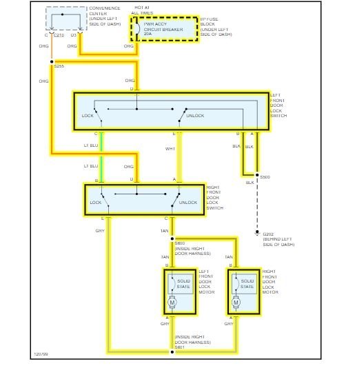

Hi. Im looking for wiring diagrams for Power door lock system.
My problem is when I lock and unlock the door by switch from diver's and passenger's side and remote key all works without rear both side door unlock.
Front door lock and unlock works. Rear door works for lock but doesn't work unlock.
I check power to rear door lock actuator. One way comes power(lock), but another way doent come power(unlock).
They have 2 wires pink and gray. I checked short.
Pick wire doesnt have short. But gray wire has short.
Front side doesnt have any short.
So I think the gray wire something wrong but I dont have wiring diagram for door lock.
Please some one give me the diagrams for door locks.
I already got wiring diagrams for driver's side door module and passenger side door module. But I need door lock wiring diagrams.
Thank you for your time and help.

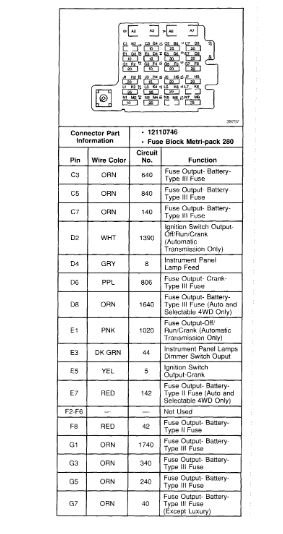

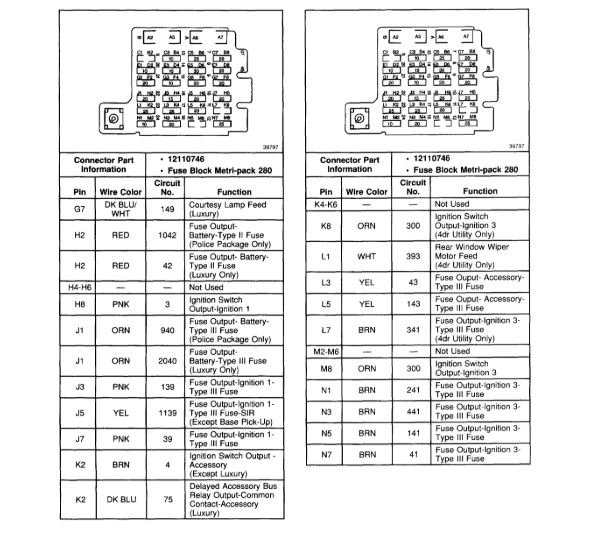

FACTORYJACK
  • 4,159 POSTS

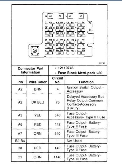

Do me a favor first, look on your option sticker that should be on the inside of the glove box door. I am looking for option YE9. You make mention of the vehicle having door modules, it looks like only the YE9 option has door modules. If you have YE9, it could be a very simple test. Locate your I/P fuse block, which I believe is under the left side end cap. There are two relays labeled lock and unlock. Swap the two relays. If now the rear doors unlock, and not lock, replace the relay that is now in the lock relay cavity.
+1
Saturday, May 23rd, 2020 AT 9:50 AM (Merged)
TAK
  • 14 POSTS
Yes, I checked relay its works. Front door lock and unlock all works. Only rear unlock is not working.
I pulled out one connector from fuse box witch is you told me.
From connector to rear door is okay. But I check power from fuse box side connector when I push lock unlock.
Lock side I get power from it but I didnt get power from unlock side.
So I guess fuse block is something wrong.
I will check more.
+1

You never stated if you had YE9, I can only guess you do if you are having rear door issues. Here is some schematics. Sorry about the size, it is the best reproduction I can do.
Actuators - Crew Cab w/YE9
https://www.2carpros.com/forum/automotive_pictures/309872_1242066_1.jpg
https://www.2carpros.com/forum/automotive_pictures/309872_1242065_1.jpg
https://www.2carpros.com/forum/automotive_pictures/309872_1242063_1.jpg

If you could ground the tan/black wire as shown at the BCM, it could control the relay as well. If there is no power on the tan and black wire, then there is a problem with the power to, or through the relay.
