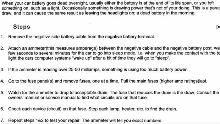

Need to do a Battery drain test. Do you have a DVOM and a little electical savy?

O.K. With 50 amp INT in place after hooking meter up for 30sec what is draw. Then in I/P fuse box removefuse #13 aux pwr does it drop? Repeat for fuse #9 rdo and #7hdlp let me know. Assume no wiring diagram?

With the engine off, check battery voltage. Then have someone crank the engine and see what the voltage drops to. It should go no lower than 10.0/10.5 volts. Then see what it says with the engine running. It should be at least 13.2-13.8 volts.
Next, you need to take it to a place like Autozone or Advanced and do a 'starter draw test' to see how much current the starter is drawing from the battery.
These tests will give us an idea of what's going on.
Never test a circuit with a multimeter on the 10A setting if you have any reason to believe the circuit has more than 10A running through it. You will fry even a very good meter every time. I've done it a few times. With expensive meters.

Hmmmm. Ok. If you remove one of the battery cables, what sort of spark do you get? A little little one, or a substantial one?
Pull fuses in the interior fuse panel one at a time and repeat the battery cable-spark test until you have no spark anymore. At that time you will have found the problem circuit. Then you just need to figure out what the problem is with that circuit.

Use a test light, not a meter. Pick up a cheap pigtail and bulb. Like this:
http://shop.advanceautoparts.com/webapp/wcs/stores/servlet/product_light-socket-bwd_22070024-p?navigationPath=L1*14920|L2*15003|L3*15623
Secure one end (the wire end is easiest on a GM product) to the negative battery cable and the other end (bulb end) insert one of the tabs into the threaded opening on the battery. Using a tissue, plug in a bulb and observe how bright it is. With a digital stereo and security system, you're always going to have a slight drain. The bulb should be VERY dim. Start pulling fuses from the 'convenience center' inside under the dash until the bulb dims noticeably. You've found your problem circuit. Quit wasting money burning up meters.
