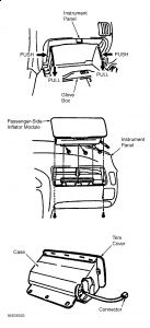

I have been told to remove the dash in order to replace the heater core, but I am not sure what would happen if I mess with the air bags. The manual says to disarm them but it is really vague on where or how. How do I remove the dash without blowing the air bags, and then replace it so that they wont go off as soon as I reconnect the battery?

Hello -
I will attach the info on the dash - air bag for you. Please be extremely careful when working with the airbags as even static can set them off. So be extremely careful even when you carry it.
Also many times you don't have to remove the dash airbag as the dash comes off with it connected after you unplug it. So look really close and again be careful.
I have given you what we have to remove both airbags to include the dash if you have to remove the dash one.
DO NOT turn the key on until all the connectors are plugged back in on those airbags. On many vehicles the system will do a self check and if a bag is not connected it will throw a fault and it can only be cleared by taking it to the dealer and putting it on their tester.....it runs the check and clears the light. So NO POWER on until all is back together.
I also gave you info on just the Metro not the Metro LSi.

DISABLING & ACTIVATING AIR BAG SYSTEM
WARNING: To avoid accidental air bag deployment and possible personal injury, be sure to wait at least 2 minutes, after disabling SIR system, before beginning work on system.
1. Straighten vehicle's front wheels and turn ignition switch to LOCK position. Remove key from ignition.
2. Locate air bag fuse box (near base of steering column) and remove AIR BAG IG fuse.
3. Remove steering wheel side cap. Disengage Connector Position Assurance (CPA) clip and disconnect driver-side inflator module.
4. Pull top of glove box outward while depressing stops. Allow glove box to fall toward passenger seat. Disengage CPA clip and disconnect Yellow connector for passenger-side inflator module.
5. To activate SIR system, turn ignition switch to LOCK position and remove key. Reverse steps 2 through 4 above. Turn ignition switch to RUN position and verify that AIR BAG warning light flashes 7 times and turns off. If AIR BAG warning light does not function properly, perform SIR DIAGNOSTIC SYSTEM CHECK under TESTING - DIAGNOSTIC.

PASSENGER-SIDE INFLATOR MODULE
CAUTION: When carrying a live inflator module, always be sure to keep trim cover pointed away from your body. When placing a live inflator module on a work bench or other surface, be sure that trim cover is facing upward (away from surface).
Removal & Installation
Disable SIR system. See DISABLING & ACTIVATING AIR BAG SYSTEM. Remove 5 retaining screws from passenger-side inflator module, and remove module from vehicle.
Installation
1. To install, position passenger-side inflator module into vehicle upper dash pad. Install 5 retaining screws. Torque 2 upper side screws to 49 INCH lbs. (5.5 N.m) and 3 bottom center screws to 198 INCH lbs. (22.5 N.m). See Fig. 7
Fig. 7: Installing Passenger-Side Inflator Module
Courtesy of GENERAL MOTORS CORP.
http://www.2carpros.com/forum/automotive_pictures/248015_7_23.jpg
2. Reconnect the passenger-side inflator module connector and re-engage the CPA clip. Activate the SIR system. Refer to procedures in DISABLING & ACTIVATING AIR BAG SYSTEM .
