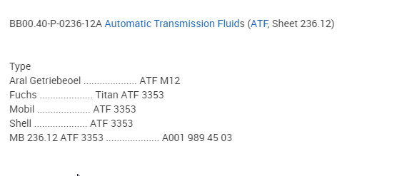

I had a mechanic change the automatic gearbox oil in my car. When i got it back i noticed that it is now taking longer to go through the gears and is louder on the engine.
Oct 29, 2019 at 8:10 AM
  • CAR REPAIR CONTRIBUTOR

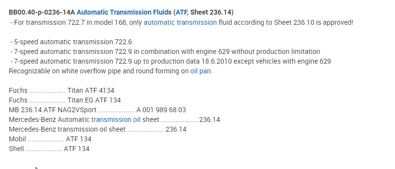

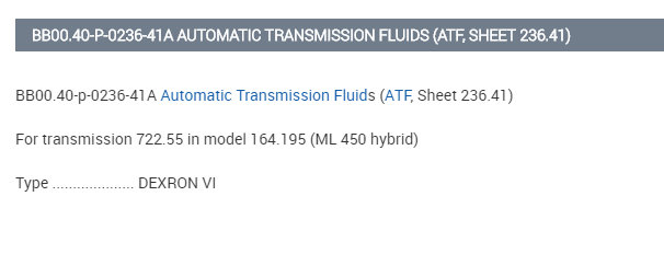

Assuming these are related, we need to make sure the fluid used was correct and that they didn't put any additives in it. I attached the specs depending on what transmission you have. However, I would take it back and have them look at it if this happened immediately after.
They may not have done anything wrong but they need to check it just to make sure.
