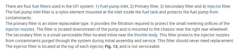

Does the car listed above Mach6 model have 2 fuel filters? I got what should have been a match but looks to me like it may have an inline and a spin on.
Just got this car to restore so haven't had a lot of time to check it over
Thanks

Good morning,
Can you post a picture of the fuel filter you have?
I posed the information below. There are 4 fuel filters. Only one is serviceable.

Thanks Roy, seems I did get the correct filter although it doesn't look quite right.
