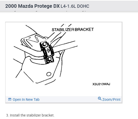

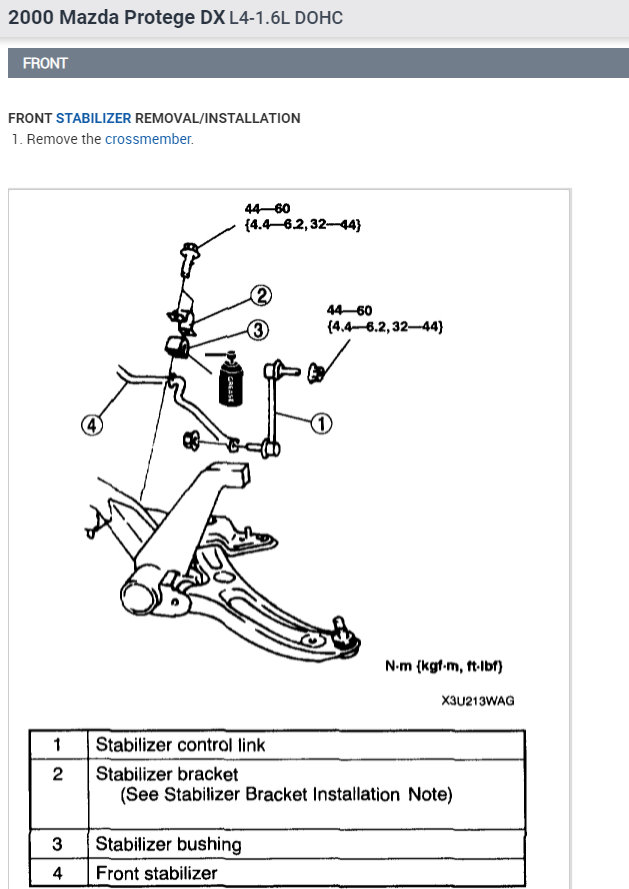

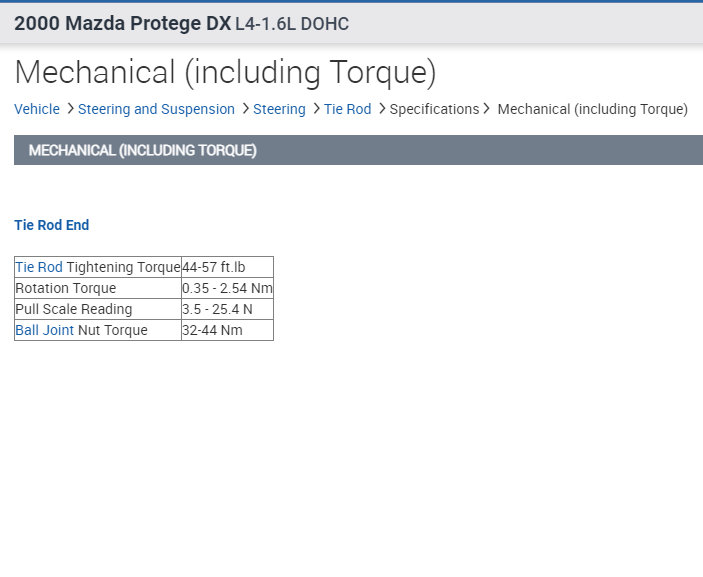

I usually see recommendations of between 22-30 Ft-Lbs. for the outer tie rods but haven't seen anything specific for the Sway Bar End Link torque specs.
Apr 12, 2022 at 8:41 PM
SQM
  • CAR REPAIR CONTRIBUTOR
  • 6,383 POSTS

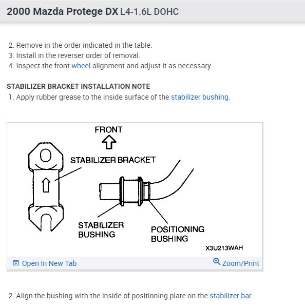

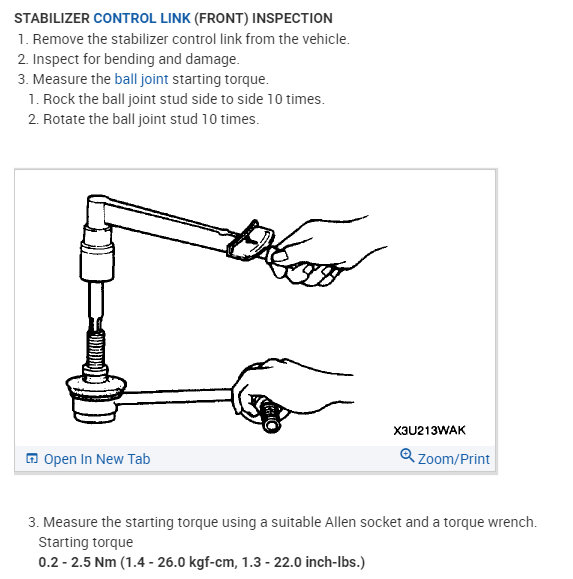

Please see attached for the torque specifications.
https://www.2carpros.com/articles/how-to-replace-a-sway-bar-link
Let me know of any questions.
