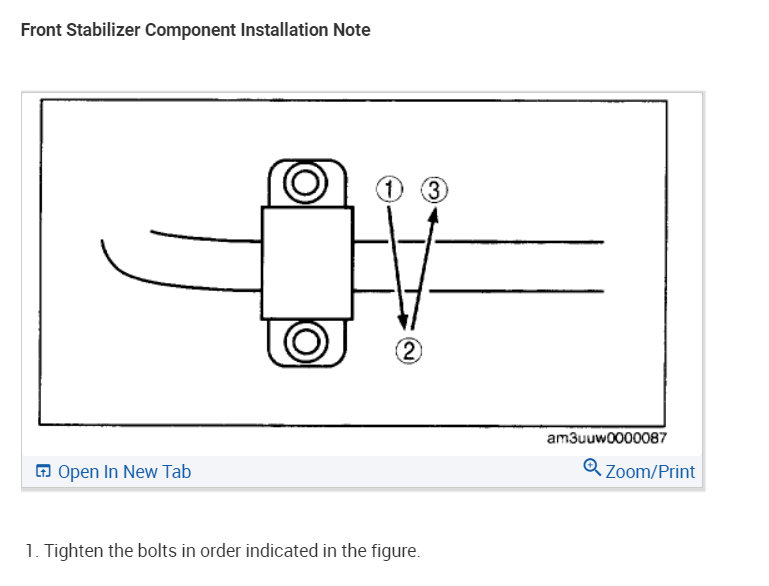

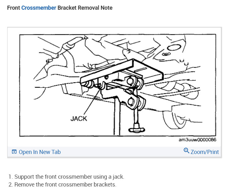

When driving the front-end rattles bad and the rear-end. My car fishtails on certain parts of the highway. I replaced both driver side and passenger side CV axles, and it still rattles bad!
May 16, 2022 at 8:59 AM
  • CAR REPAIR CONTRIBUTOR
  • 54,334 POSTS
I have seen the sway bar links are main frame bushings go bad and make noise along with the fishtail you are talking about. Here is a guide to help you see what's going on. If you uploaded a short video of the noise, we can tell for sure. You can do so in your response.
https://www.2carpros.com/articles/popping-noise
and
https://www.2carpros.com/articles/how-to-replace-a-sway-bar-link
May 16, 2022 at 6:27 PM
