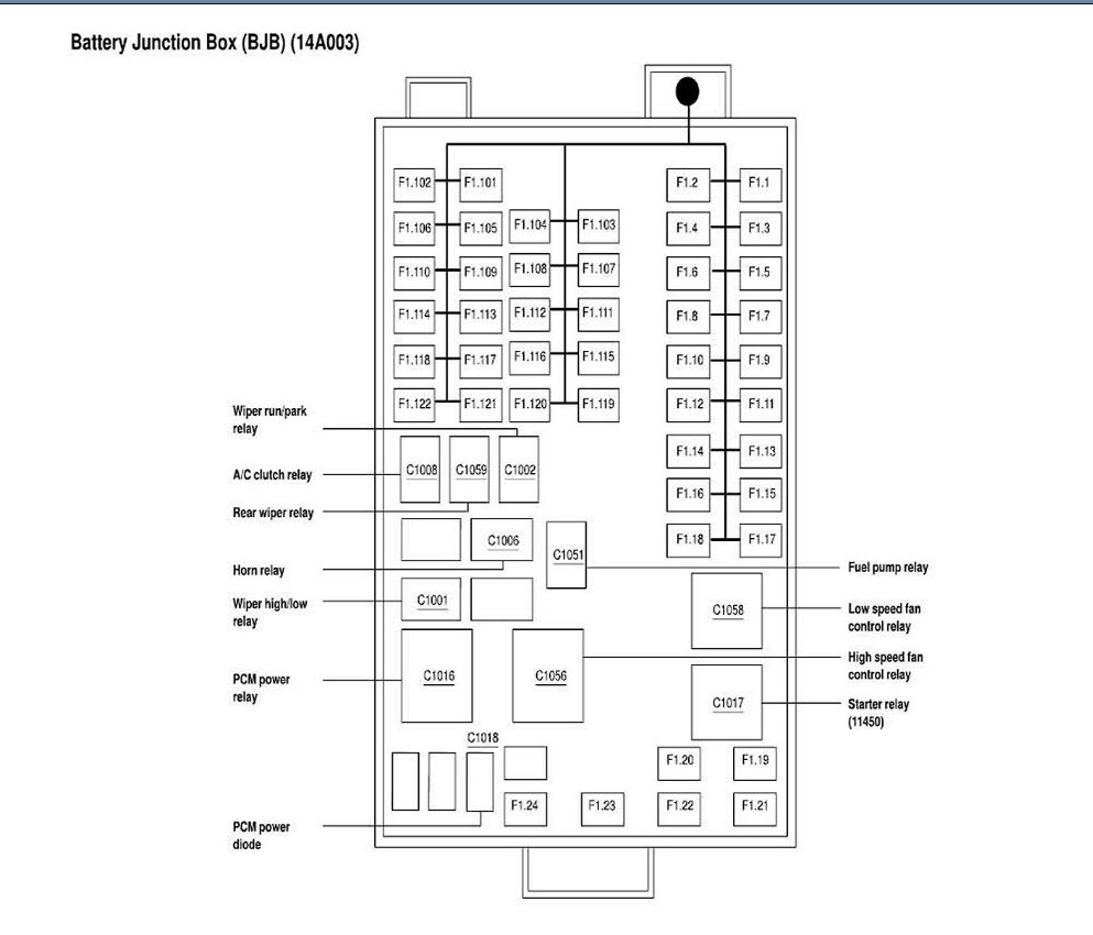

What are the causes of the fuel pump not engaging? Installed new fuel pump and it is not engaging. What are the areas that need to be checked? Also check tires and reset appears on the led screen of vehicle.
May 1, 2009 at 8:52 PM
  • CAR REPAIR CONTRIBUTOR
  • 75,992 POSTS
It sounds like the relay is not working here is a guide to help test it and the location of the relay below.

where is the fuel pump relay located? and what dose it look like?
Feb 12, 2019 at 4:54 PM (Merged)
  • 75,992 POSTS
It is located in the battery junction box.
https://images.2carpros.com/forum/automotive_pictures/12900_bjb_1.jpg
It should look like this:
https://images.2carpros.com/forum/automotive_pictures/12900_fpr_14.jpg
