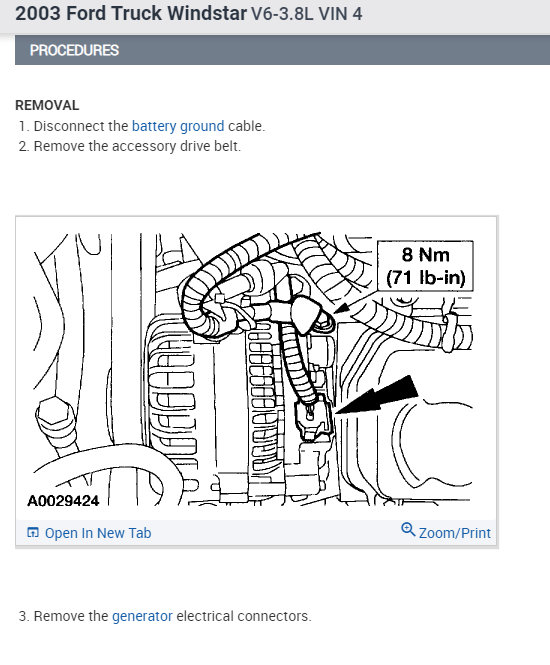

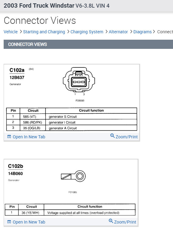

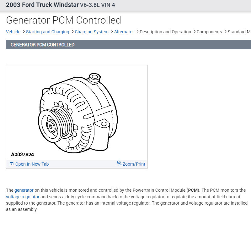

Sounds like the regulator in the alt may be bad.The light may be coming on due to overcharging (almost 15 volts). Be sure the ground on the engine is clean and tight.
This guide should help test it.

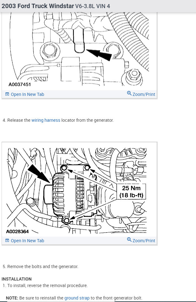

Faulty voltage regulator in the alternator can overcharge the battery, it is possible for the regulator to be not stable and fluctuate on the output. Which could explain the intermittent battery light.
It can also be due to a loose ground strap on the alternator. Make sure that ground is secured and clean of any corrosions.
https://www.2carpros.com/articles/how-to-replace-an-alternator
