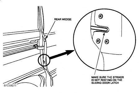

2000 Ford Windstar 6 cyl Front Wheel Drive Automatic 175000 miles
While we are at about 30 mph or higher the Automatic Sliding door will start to rattle. If you pull on the handgrip you can make it stop. Is there anything I tighten to make it stop. Please give step by step instuctions if possible.

open door and check the rolling bearing at the bottom
most common I have seen it lost its plastic insulator and need replacement
ISSUE
The sliding door may "squeak" and/or "rattle" when going over bumps. This may be caused by a misaligned sliding door.
ACTION
Perform the Sliding Door Adjustment Procedure outlined in this TSB. This should reduce the possibility of noise by restoring proper alignment. Refer to the following SERVICE PROCEDURE for details.
SERVICE PROCEDURE
The following procedure is used to repair windnoise, water leaks, and squeaks and rattles that are diagnosed as coming from the sliding door. The procedure consists of adjustments that are made to the sliding door to properly locate it in the sliding door opening.
How To Use This Service Guide: The fit of the sliding door is of foremost importance for preventing rattle from the sliding door area. Before performing repairs on the sliding door, verify the rattle is located in the sliding door area. This can be accomplished by driving over semi-harsh bumps with a driver and a 2nd row passenger near the sliding door.
Before any adjustments for fit are made, follow Steps 1, 2, 3 and 7 - in that order.
Does "A" improve the alignment of the sliding door and stop the squeak and/or rattle? If YES, then the door is properly adjusted for minimizing squeak and rattle concerns. Retorque all bolts per specifications in Step 8. If NO, proceed to "C".
After performing "A", if the sliding door is still obviously misaligned for fit, follow Steps 1, 4, 5, 6 and 7 - in that order.
This guide was formulated by trained Windstar technicians, and is the plant's process for repairing the sliding door for squeak and rattle concerns.

STEP 2 - ADJUST C-PILLAR WIRE STRIKER
The next adjustment to the sliding door is to check the alignment of the C-pillar striker
With the door all the way in the closed position, check the inboard/outboard up/down position of the striker to the latch. The striker should be sitting directly in the center of the latch for the up/down position.
The latch should NOT be resting on the bottom or the top of the striker when the door is almost in the closed position or in the closed position
When the striker rests on the top or bottom of the latch, vibration from road conditions will cause the door latch to rattle on the striker.
You can check the centering of the striker, by slowly opening and closing the door and watching the striker operate in the latch. The adjustment should be apparent after subjectively viewing the mating of the two components and any witness marks for wear on the striker.
Loosen the striker 1-3 turns so that it is snug but not loose. If the striker is loose, it will not stay in the position you adjust.
Up/Down Adjustment of the Striker: Again, the striker must be not be seated or touching the top, bottom or sides of the latch. Adjust the striker to the center up/down and inboard/outboard position by tapping the striker and checking its position after each tap.
NOTE:Once these steps are performed, all other adjustments can be referenced to the C-pillar striker. This striker must be adjusted first, then subsequent adjustments can follow.

Rear C-Pillar Wedge
The rear wedge should engage smoothly as the door closes tightly. The plastic tape on the C-pillar should be aligned to contact the wedge smoothly as the door engages.
Make sure the wedge retracts properly on closure. Failure to engage on the body can cause door rattle. Apply a thin layer of Silicone (F7AZ-19G208-BA) to the two (2) B-pillar wedges and the C-pillar wedge.
