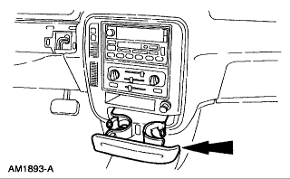

Are you talking about going behind this-see pic
https://www.2carpros.com/forum/automotive_pictures/12900_ac_and_heater_trim_1.gif

2CEXPT
  • EXPERT
Not sure never done it on this vehicle:
REMOVAL
Disconnect the battery. CAUTION: The slider knobs are illuminated using a LEDs. Use care not to damage them when removing the slider knobs.
https://www.2carpros.com/forum/automotive_pictures/12900_c1_1.gif
Remove the ash receptacle.
Remove the audio unit. For additional information, refer to Radio, Stereo, and Compact Disc.
https://www.2carpros.com/forum/automotive_pictures/12900_c2_1.gif
Remove the screws.
https://www.2carpros.com/forum/automotive_pictures/12900_c3_1.gif
Unsnap the panel.
https://www.2carpros.com/forum/automotive_pictures/12900_c4_1.gif
Disconnect the connectors.
https://www.2carpros.com/forum/automotive_pictures/12900_c5_1.gif
Remove the control assembly.
Remove the screws.
Tuesday, December 20th, 2016 AT 6:08 PM (Merged)
