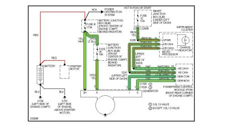

I was driving this morning and then the lights all turned off, the car drove rough and then after a few minutes, everything came on and then after several miles the check charging system light came on several times.

Get the charging system checked out especially the computer controlled field generation voltage regulator see below
http://www.2carpros.com/forum/automotive_pictures/12900_PCM_field_generation_1.jpg
