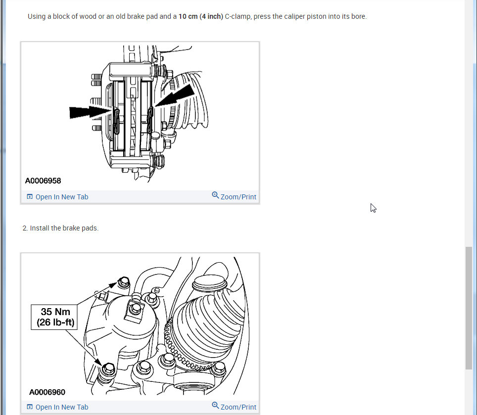

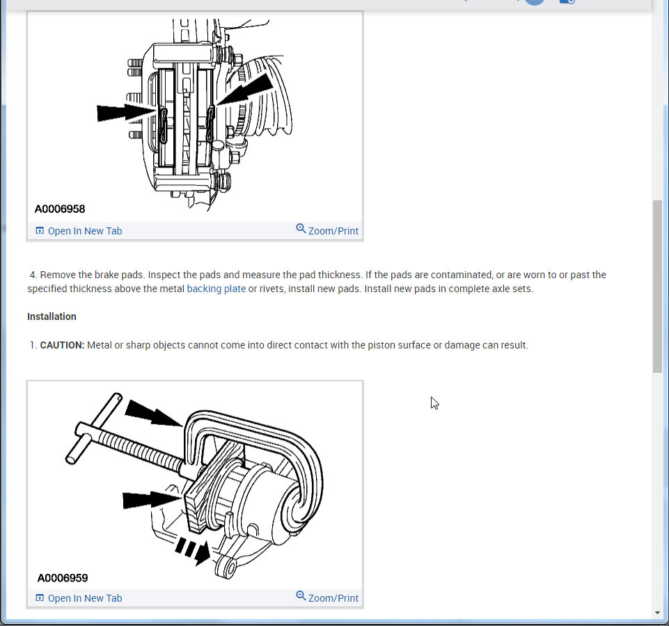

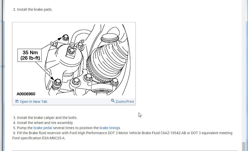

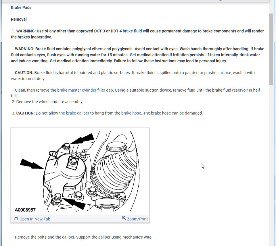

Here is a video and a guide that will show how to do this:
https://www.youtube.com/watch?v=pv1wWJLxCtc
Below is the process on how to replace the brakes from the manual. Let us know if you have other questions. Thanks
