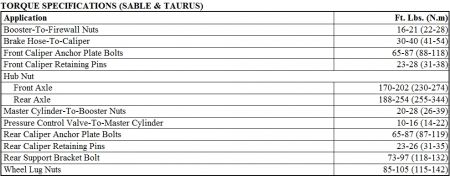

What are the Torque Specifications for the rear brake caliper on a 1998 Ford Taurus?
