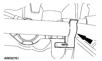

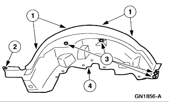

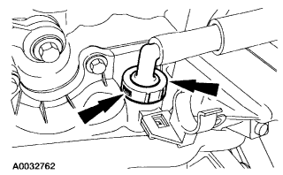

Where is the PCV valve on my 2002 Ford Ranger with a 2.3L DOHC engine. Im getting a code P0171 and I've checked everything except this.

Remove the left side inner fender well splash shield.
1 Remove the screws.
2 Remove the pushpin.
3 Remove the bolts.
4 Remove the splash shield.
CAUTION: Remove the electrical connector locators from the splash shield prior to removal.
http://www.2carpros.com/forum/automotive_pictures/12900_p2_3.gif
Disconnect the coolant bypass hose from the routing clip.
http://www.2carpros.com/forum/automotive_pictures/12900_p3_3.gif
Gently pry the Positive Crankcase Ventilation (PCV) valve cap off the two tabs.
http://www.2carpros.com/forum/automotive_pictures/12900_p4_3.gif
Remove the PCV valve from the crankcase vent oil separator and disconnect the vacuum hose.
INSTALLATION
To install, reverse the removal procedure.
