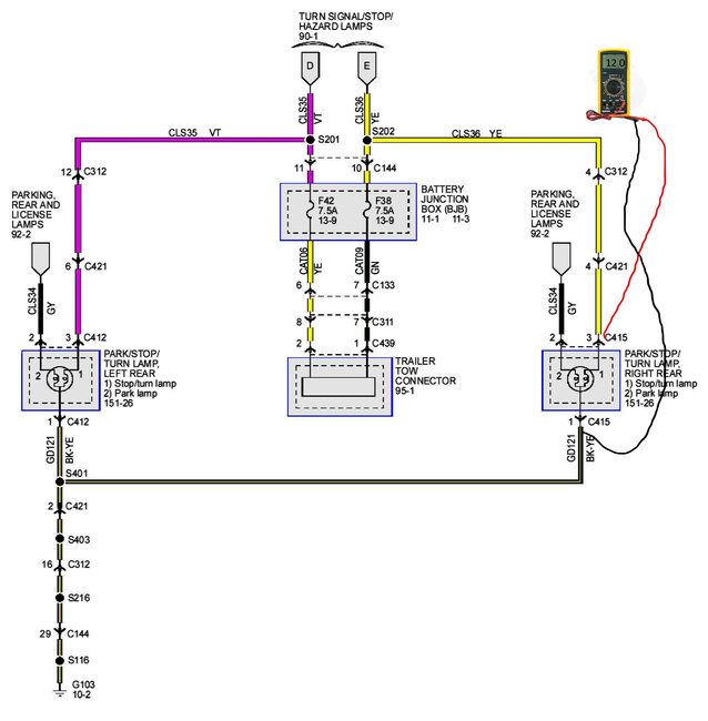

Truck listed above - Book at Walmart indicated replacement bulb is 4157 which I installed. Worked at first but next day back to same issue. Checked on line and replacement bulb was listed as 3156 which is big difference. Installed the 3156 and still no rear turn signal on right side. Front right signal is flashing fast but working. Left side is no issue.

According to Sylvania the rear turn signal bulb should be a 4157. You could possibly have a faulty bulb socket due to loose terminals that will make a break contact with the bulb, thus the bulb that worked for a day. You can do some basic circuit tests at the socket to check for power and ground as this will verify if your issue is with the bulb or the circuit/s. I attached a basic test with a voltmeter to verify power and ground with the turn signal switch in the right turn position with the key on. If you don't show voltage place the ground lead on a good chassis ground, if it then reads voltage... bam! a bad ground, to which you can either wire in your own ground or hunt for the broken/corroded wire. This guide can help us fix it.
https://www.2carpros.com/articles/turn-signals-not-working-blinker
If there is still no voltage reading after trying a different voltmeter ground, remove the column shroud to access the switch and check voltage at the yellow wire, if no voltage there=bad switch, If voltage good, trace the circuit until you find the broken wire or run your own wire from the switch to the rear (no fun). Hope this helps!

Thanks for the tip. Since it worked once new 4157 bulb was inserted, did not think it could be a ground issue. Will check that per your suggestion.

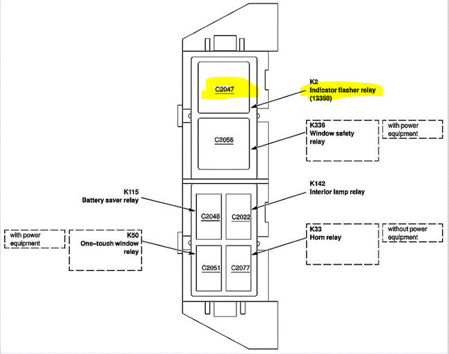

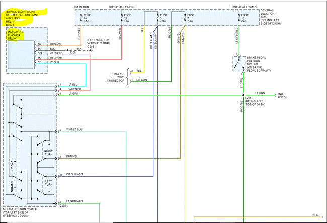

My rear turn signal/hazard light do not flash. I have noticed that all of the lights work when needed-(reverse lights light up and rear drive lights light up), but they do not flash when I turn the signal on. The front turn signals/hazard light work fine, but the rear ones do not. Also all of the fuses in the cab are fine. I was wondering what a possible cause might be. I was thinking it might be the flasher relay. What do you think?

It does sounds like the flasher unit but to be sure this guide can help us fix it I have added the flasher location int ehdaigrams below.
Check out the diagrams (Below). Please let us know what happens. They call it an indicator relay

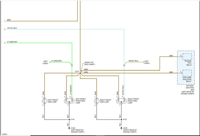

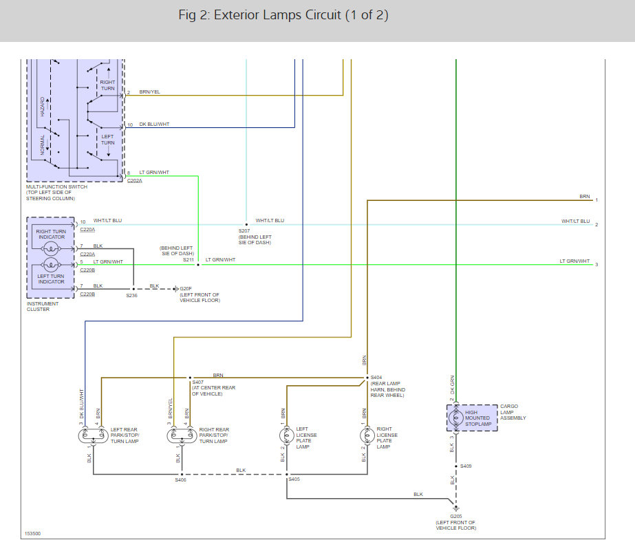

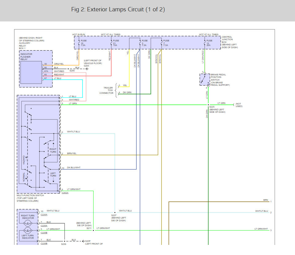

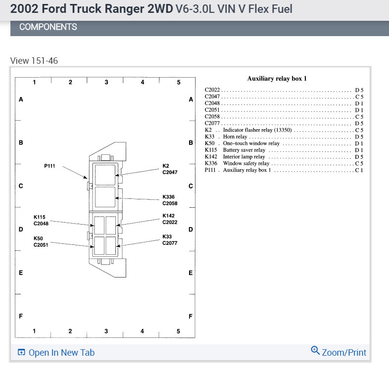

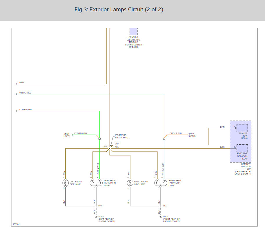

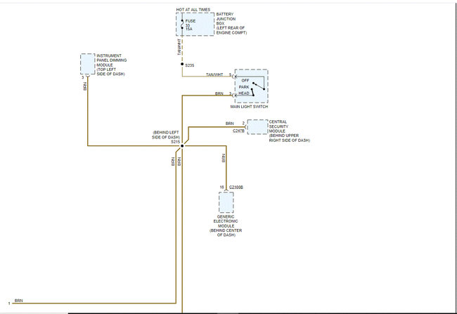

None off my blinkers will work, i've replaced all the fuses. I think it has some thing to do with the clicker box under the dash. But i, m not sure witch one it would be. Do u know where I could get a diagram that would tell me?
Wednesday, June 2nd, 2021 AT 2:01 PM (Merged)
  • 108,005 POSTS

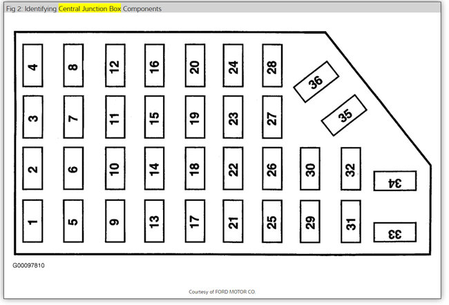

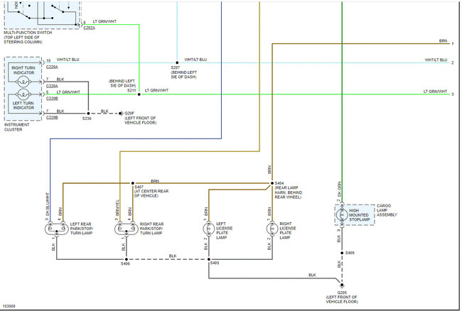

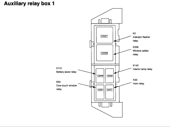

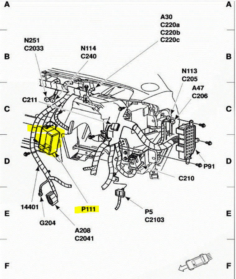

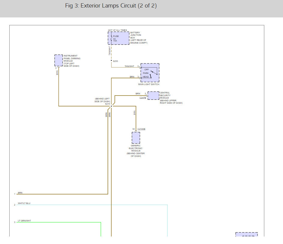

First, I attached the wiring schematic for the entire exterior lighting system for your review. I had to cut the pics in half to make them readable; however, I did overlap them so you can follow from one to the next.
If you look at pic 1, I highlighted the flasher and its location. pics 2, 3, and 4 are the remainder of the schematic.
If you look at pic 5, it shows the location of the auxiliary relay box #1. The last pic indicates the flasher's location.
Here is a link you may find helpful when testing:

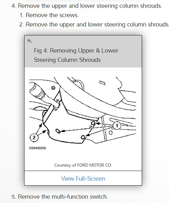

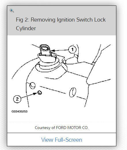

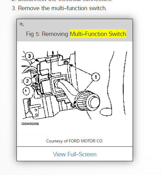

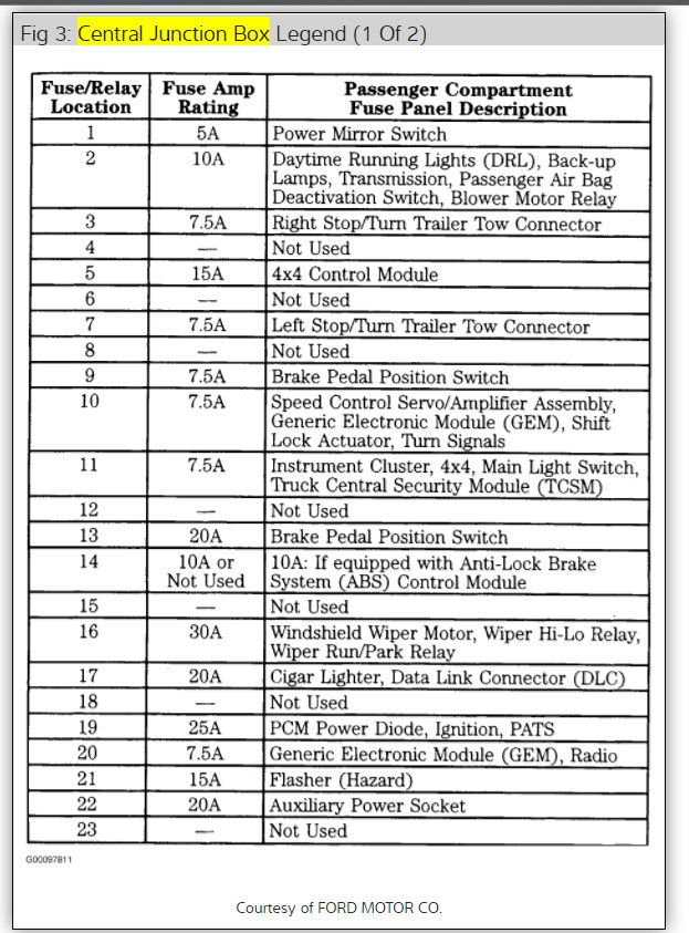

It sounds like the multi function switch is not working. To confirm lets use this guide to check for power at the switch with the blinker and brake light wiring diagrams below, also lets check for power at the fuses.
+1
JOHNELLIOTT
I replaced the multi-function switch, no change. I'm taking it to a shop, feel like I’m over my head. I appreciate the help. It’s good to know there is help out there. Thank you much.

Can you please check fuse # 3 and #7 in the fuse box inside the truck?

I did check fuses and bulbs. Truck is in shop and they haven’t found anything yet. Probably three hours at $80.00 per.

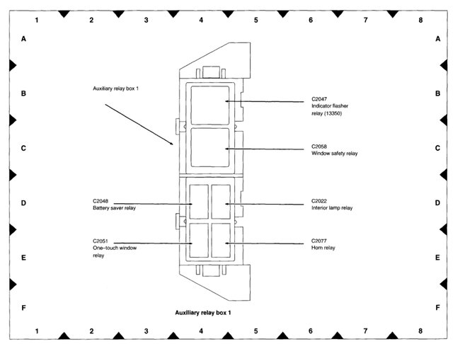

Hi, want to try replacing the relay for the turn signals and hazard lights as they are not working. Have searched the internet for tons of diagram/illustrations and cannot find the auxiliary relay box where the relay for said signals/hazard lights go. Any help? Thank you very much. PS. I have not wrenched on a car (1967 Chevelle) since 1984).
KEN L
  • MASTER CERTIFIED MECHANIC
  • 42,554 POSTS
There is a flasher relay that sounds like it is bad here is the location. Check out the diagrams (below). Please let us know what you find.

BMDOUBLE
  • 1,139 POSTS

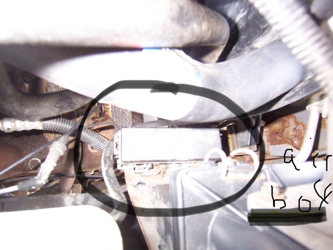

It is mounted below the air filter housing. I’ve added a picture along with the relay box layout. Hope this helps!

JOHNELLIOTT
It was the flasher. It is fixed and I’m pleased with the cost and the work. Thank you, it’s nice to have a place to go and learn from like here with you.

MARKREGAN
Thanks for your response/answer. Is that below the cabin air filter, kind of under the dash, almost behind the stereo area, to the right of the gas pedal (more or less)? I see a box up there that sort of looks like that. Thanks again.

BMDOUBLE
  • 1,139 POSTS
Yes that's the one, my apologies for a bad picture!
