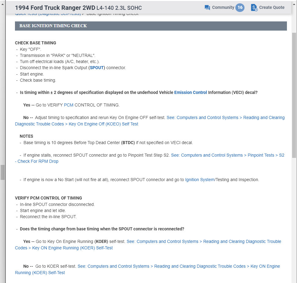

JBS111096
No check engine light problems and I think we have ruled out a vacuum leak. Could it be that the timing is off? Again, no issue at all other than idle.
+1
Thursday, March 9th, 2017 AT 2:17 PM (Merged)

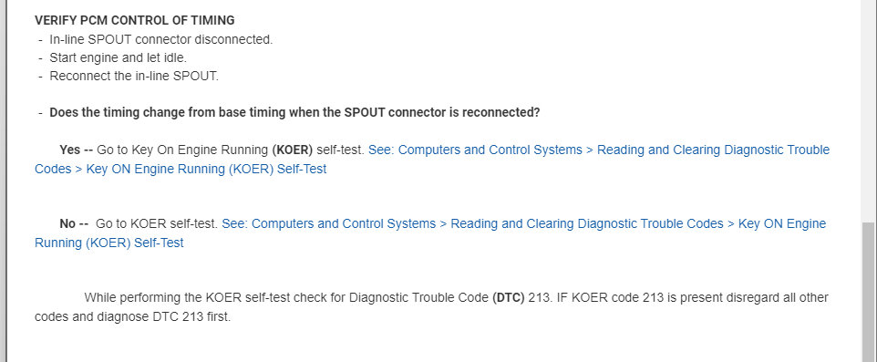

BLACKOP555
  • 10,371 POSTS
Yes. This could be a timing issue so we should start with checking it.
I am attaching the info from the manual on how to do this.
  • 108,117 POSTS
I would think that if it was timing, it would be felt all of the time. To me, it sounds like a vacuum leak or maybe there is a carbon build up in the EGR and it isn't working properly. Also, I don't know the history of the truck. If it has had a rough life, you may want to check compression to make sure that you don't have a weak cylender.
