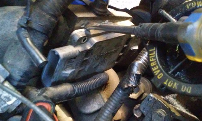

New coil packs two. New spark plugs eight. New spark plug wires eight. Still no spark on passenger side cylinder first plug closest to belts. Does camshaft sensor have anything to do with this problem? Every now. And then it would get spark and motor would run right but short lived. Please help if you may know what's going on because I am stumped. Thanks. Lee.
+1
Wednesday, July 29th, 2020 AT 11:45 AM (Merged)
STEVE W.
  • 12,964 POSTS
Welcome to 2CarPros. The cam sensor would shut down all of the plugs not just one. Your description sounds more the the ignition control module having a bad transistor driver for cylinder one. It is the only part that controls which cylinders fire at what time. I would start by removing it, cleaning the areas around the screws (they ground the module) then apply some dielectric grease and re-mount it. See if the cleaning of the grounds and reseating the connectors cleared up the problem. If not you will want to replace the module.

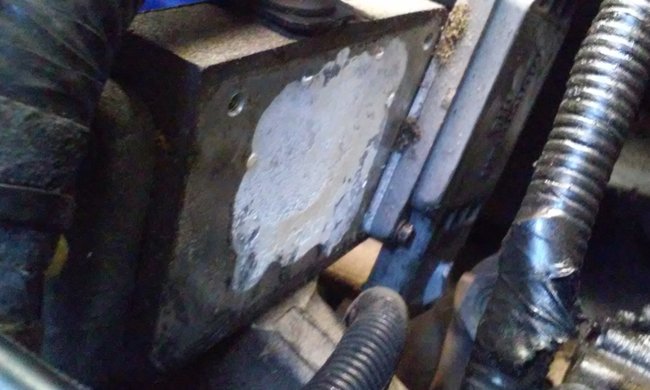

WILLIAM PENDLEY
  • 15 POSTS
Mr. Steve goodmorning. Here is a photo! What do you think?
+1
WILLIAM PENDLEY
  • 15 POSTS
Mr. Steve my brother. I followed your steps and I want to thank you for taking time out of your life to help me. Just to let you know. My truck listed above is running better than it ever has. Thanks again. Lee!
STEVE W.
  • 12,964 POSTS
Great to hear. The pictures looked like it had a lot of corrosion. Please return anytime with your automotive questions.

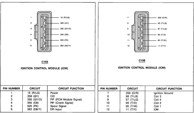

I am having trouble's with my 93 ford ranger with a 3.0 and I can't get no spark after changing distribtor's coil n computer and still have no spark at all can't figure out what it is

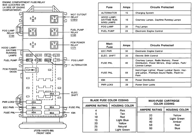

HMAC300
  • 48,601 POSTS
Check fuses first and pcm relay then check red/lt grn wire on ignition moduel, dist and coil and see if power is going there. It may be a bad connector on either end and or a coil isn't good.

WILLIAM PENDLEY
  • 15 POSTS
Hi Mr. Steve. The truck is doing it again. This time the spark to that cylinder is staying longer then stops sparking. What do you think? Could it be the ICM going bad or something else?
WILLIAM PENDLEY
  • 15 POSTS
Mr. Steve, I didn't put any dielectric grease on it before I put it back on. Would that be the cause and why?
WILLIAM PENDLEY
  • 15 POSTS
Mr. Steve my ICM has only 3 screws. There are 4 holes on the ICM but on the manifold there is only 3 screw holes.
STEVE W.
  • 12,964 POSTS
Sorry to hear that, more than likely it is failing because it didn't have a good ground for a while and it started damaging the transistors that are in the ICM. The cleaning showed it had an issue but it was a bit late to fully cure the problem. Replacing it should take care of the misfires and give you back a running truck. As for the 3 mounting screws, that isn't a problem, the two that ground it would be on the side where your screwdriver is pointing. The "missing" one isn't really needed. It's another of those "cost savings" items companies are famous for. The grease is there to allow for better heat transfer between the module and the manifold, leaving it off wouldn't be good for the long term but your module was already showing signs of failure so it wasn't the cause. When you install the replacement you can coat it with a thin layer. There will usually be some included with the new module. Check before you leave the store.
