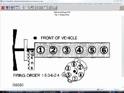

1976 Other Ford Models firing order
1976 FORD
70,200 MILES • 6 CYL • 2WD • AUTOMATIC
RUVIAN
During my sons first tune-up he removed 3 plug wires off the cap before I noticed. I need to know what the firing order is please.
