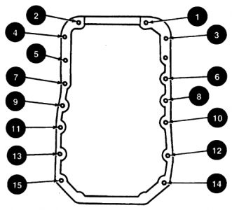

I need to know how to repair a oil pan seal in my car at school ima jonior and need to know the easiest way to change it

Replacement procedures for your oil pan seal are below. These instructions are for the 3.8L engines. Please specify if you have a different size engine.

Remove the oil pan. Pour any residual oil out of the oil pan.
If necessary, remove the oil pump screen and tube retainer bolts, and support bracket nut. Remove the oil pump screen cover and tube. Discard the old oil pump inlet tube gasket.
((Be sure to tighten the oil pan mounting bolts in the sequence shown to ensure proper sealing))

Apply a bead of silicone sealer, such as Ford Silicone Gasket and Sealant F6AZ-19652-AA, to the oil pan.
Install the oil pan, then install all of the oil pan mounting bolts. Tighten the bolts, in the sequence shown in the accompanying illustration, to 80-106 inch lbs. (9-12 Nm).
