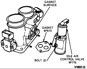

Where is the iac on this vehicle and how do you replace it?

Hello
Here is the info you requested
http://www.2carpros.com/forum/automotive_pictures/248015_1_84.jpg
REMOVAL
Disconnect negative battery cable.
Disconnect the Idle Air Control (IAC) valve assembly connector from the wiring harness.
Remove the two IAC valve retaining bolts.
Remove the IAC valve and gasket.
http://www.2carpros.com/forum/automotive_pictures/248015_2_46.gif
INSTALLATION
NOTE: If scraping is necessary, be careful not to damage sealing areas of IAC valve or throttle body gasket surfaces, or drop material into throttle body, or intake manifold.
Make sure that both throttle body and IAC valve gasket surfaces are clean.
Install gasket and IAC valve.
Install retaining screws. Tighten to 8-11 Nm (71-97 in lb) .
Connect electrical connector for the IAC valve.
Reconnect negative battery cable. NOTE: When the battery has been disconnected and reconnected, some abnormal drive symptoms may occur while the powertrain control module relearns its adaptive strategy. The vehicle may need to be driven 10 miles or more to relearn the adaptive strategy.
