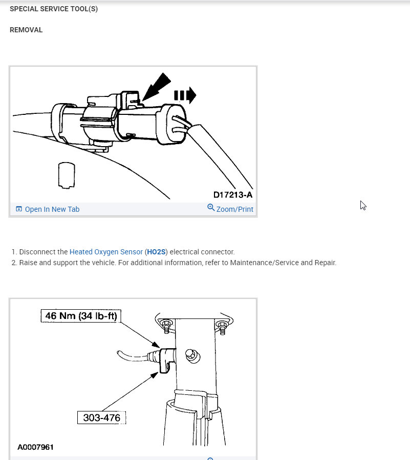

2002 Ford F150 6 cyl Two Wheel Drive Manual 53000. Miles
how to change the oxygen sensor and where its located or how to clean it

Pretty big leap going from the CEL on to changing the O2 sensor.
What codes are in it?

There are a multitude of possiblilities for a check engine light, that is why you start by getting the codes out of the computer to give insight to the problem(s). How pricy will it be to just blindly replace parts?
