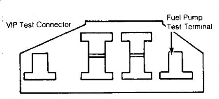

My truck will not start. I am sure it is fuel delivery problem. It has dual tanks 5.0 engine. I do not have any power at the front or rear tank connectors, rear tank has never work their is no power at the selector switch or at the inertia switch. There are four relays mounted next to the power distributor box. I change them around, I checked all fuses. I also grounded the lead of DLC connector had the same problem. One other time I keep turning the ignition off an on until I heard the fuel pump come on. Thanks if you could help me with this problem.

Do you have battery voltage at fuel pump relay socket? Can you hear the fuel pump run for just a few seconds when you turn the key to "on"?
Here is a guide to help you test to see where you are losing power along with the engine and fuel pump wiring diagrams so you can see how the system works:
I have seen the fuel pump switch valves also cause this problem FYI.
