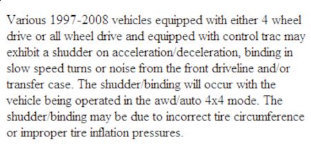

Does this seem to fit your situation?
http://www.2carpros.com/forum/automotive_pictures/30961_exp1_3.jpg
Four or all wheel drive need the same tire circumference all the way around. Put a chaulk mark at the bottme of each wheel and drive t forward for 10 rotations. IF the chaulk marks do not remain at the bottom of all four, there is a circumference problem.

I tried the chalk trick and made sure the air pressures are correct but I still have the rumble or shudder when making low speed turns. Any other suggestions?

So there was no change in where the chaulk marks ended up correct? All were at the bottom.
Could you describe this feeling as a bind and jerk as if the 4x4 was engaged?
