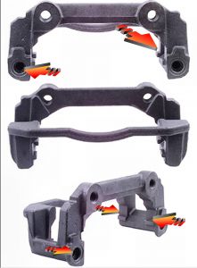

-Always clean the caliper bolts, slides, anti rattle clips and caliper brackets with a wire wheel or brush. coat the parts with quality lube.
http://www.2carpros.com/forum/automotive_pictures/30961_caliper_lube_12.jpg
http://www.2carpros.com/forum/automotive_pictures/30961_caliper_lubeareas_12.jpg
http://www.2carpros.com/forum/automotive_pictures/30961_caliper_lubeareasbrack_12.jpg
