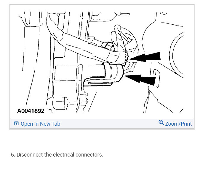

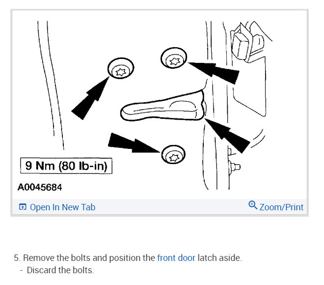

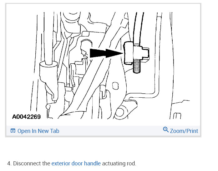

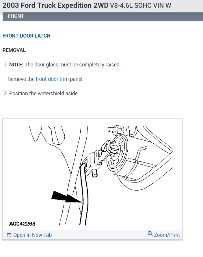

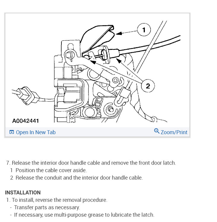

my message panel says door is ajar but all the doors are closed

Chances are one of the roll switches on the door is bad and not stopping the power to the system. You need to disconnect them one at a time to see which one is the problem. I would recommend starting with the driver's door. Also, make sure the rear hatch and window are closed tightly.
