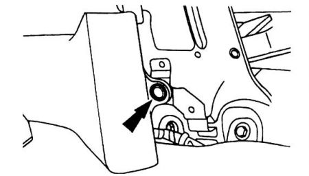

(((Unfastening the pushpins, then removing the left-hand and right-hand control box covers)))
http://www.2carpros.com/forum/automotive_pictures/261618_NoName_2.jpg

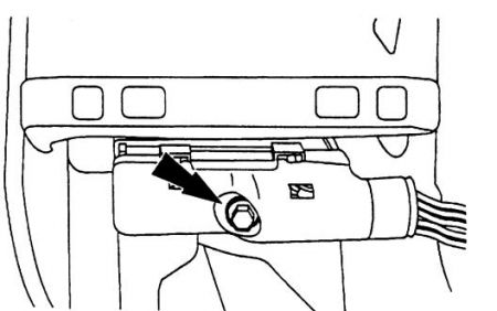

(((Unfasten the PCM electrical connector bolt, unplug the connector and move it aside)))
http://www.2carpros.com/forum/automotive_pictures/261618_NoName_4.jpg

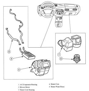

(((Exploded view of the heater core, heater housing and related components)))
http://www.2carpros.com/forum/automotive_pictures/261618_NoName_6.jpg
