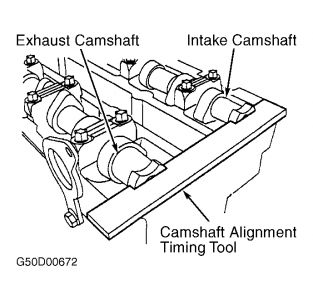

Raise and support vehicle. Remove center timing belt cover. Remove crankshaft pulley. Remove lower timing belt cover. Use Camshaft Alignment Timing Tool (T94P-6256-CH) to align camshafts. Install tool in slots on camshafts at rear of engine. See Fig. 3 .

Fig. 3: Installing Camshaft Alignment Timing Tool

Ensure crankshaft pulley timing marks are aligned. See Fig. 2 . Use Camshaft Alignment Timing Tool (T94P-6256-CH) to align camshafts. Install tool in slots on camshafts at rear of engine. See Fig. 3 . Ensure camshafts are aligned. Install intake timing sprocket and loosely install bolt. Rotate oil control bushing one complete turn and check for binding. Position bushing with single hole in 12 o'clock position.

Tighten intake camshaft sprocket bolt to 50 ft. lbs. (68 N.m). Tighten exhaust camshaft sprocket bolt to 36 ft. lbs. (50 N.m). Remove camshaft alignment tool and timing peg. Retighten exhaust camshaft sprocket bolt to 85-92 ft. lbs. (115-125 N.m). Install Variable Cam Timing (VCT) oil plug, if necessary.
Ensure second crankshaft timing mark is aligned with raised mark on oil pan. Position crankshaft just prior to TDC. Install TDC timing peg. See Fig. 1 . Rotate crankshaft clockwise against peg. Ensure camshafts are aligned. If crankshaft and camshaft are misaligned, repeat procedure until alignment is correct.
