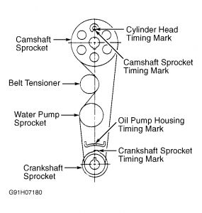

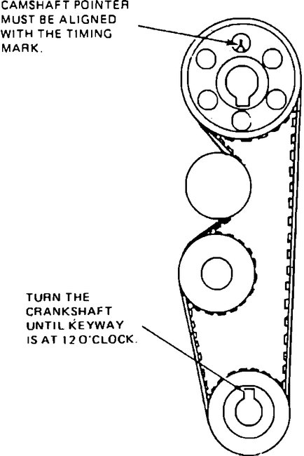

Timing belt slipped off I need to replace the timing belt?
Sunday, November 2nd, 2008 AT 6:30 PM
32 Replies
OBXAUTOMEDIC
  • 3,711 POSTS
In order to fix your timing belt you will need to take the front of the motor apart. I would suggest replacing all timing components and the water pump while in there.

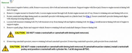

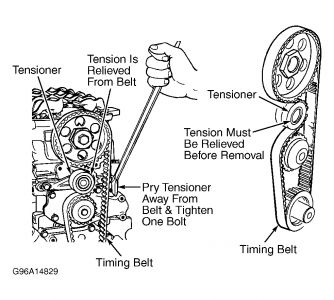

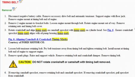

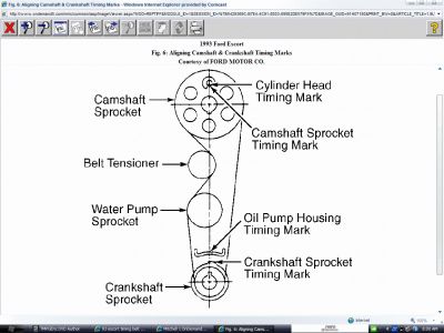

here is the removal instruction along with diagrams....
I will also email the removal istructions...
https://www.2carpros.com/forum/automotive_pictures/188069_94escortremovinstruct_1.jpg
https://www.2carpros.com/forum/automotive_pictures/188069_94escorttimimg_2.jpg
https://www.2carpros.com/forum/automotive_pictures/188069_94escorttimimgtension_1.jpg

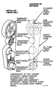

The timing belt broke going down the highway at 65mph what are the chances that it bent a valve and how if it didnt do you set the timing on the car?
Monday, September 28th, 2020 AT 10:52 AM (Merged)
DAVE H
  • 13,383 POSTS
I'm 99% sure you have bent valves ... sorry
REMOVAL & INSTALLATION
TIMING BELT
Removal
Disconnect negative battery cable. Remove accessory drive belt and automatic tensioner. Support engine with floor jack. Remove engine mount at timing belt end of engine.
Remove 2 engine mount-to-bracket bolts. Loosen engine mount through bolt. Rotate engine mount out of way. Remove retaining nuts and timing belt cover.
Rotate crankshaft and align timing mark on camshaft sprocket with timing mark on cylinder head. See Fig. 1. Ensure crankshaft sprocket timing mark aligns with oil pump housing timing mark.
Loosen belt tensioner retaining bolt. Pry belt tensioner away from timing belt and tighten retaining bolt. See Fig. 2. Install mount at timing belt end of engine to support engine.
Remove spark plugs. Raise and support vehicle. Remove retaining bolt and crankshaft damper. Remove timing belt.
CAUTION:DO NOT rotate crankshaft or camshaft with timing belt removed.
If removing camshaft sprocket, remove retaining bolt and camshaft sprocket. If removing crankshaft sprocket, pull sprocket from crankshaft.
CAUTION:DO NOT rotate crankshaft or camshaft with timing belt removed. If camshaft must be rotated, install crankshaft pulley and position crankshaft with cylinder No. 1 at 90 degrees BTDC.

this diagram is for ford escort LX

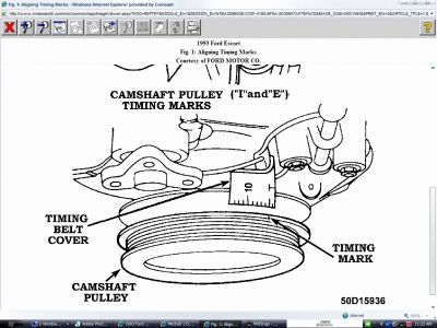

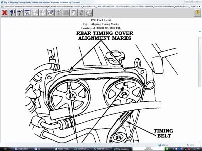

Hi I have a ford escort 1.8 16 v xr3i with the twin cam zetec and have replaced the twin cams but when putting it cams back on the head have now found out that theres timing marks on the cams is there anyway of telling how the cams are meant to sit by the way the loabs are sitting
MERLIN2021
  • 17,250 POSTS
Put the timing gers on as shown...
https://www.2carpros.com/forum/automotive_pictures/62217_18TimMarksa_1.jpg
https://www.2carpros.com/forum/automotive_pictures/62217_18TimMarksb_1.jpg
I think the bottom pulley shown here is actually the crank!

Here's a few diagrams to help, remember, dont rotate the engine with the old belt removed! Align marks first, crank mark aligns with oil pum mark, cam aligns with cyl head mark...
