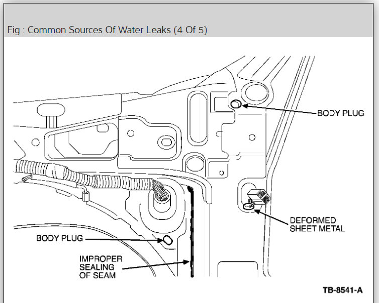

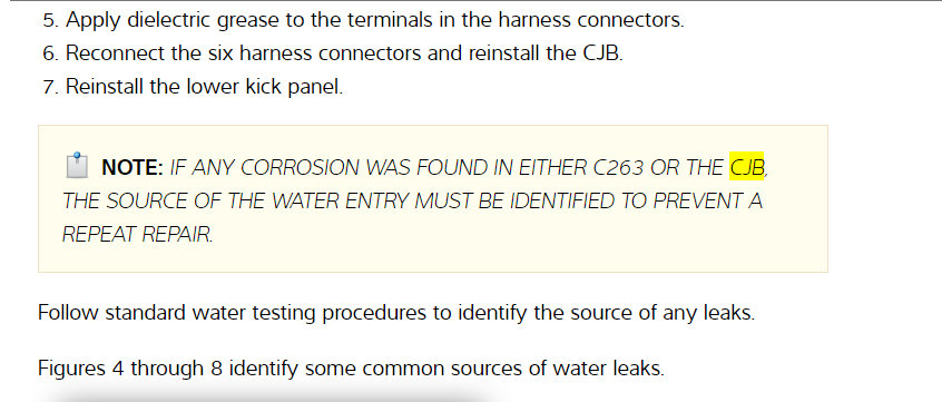

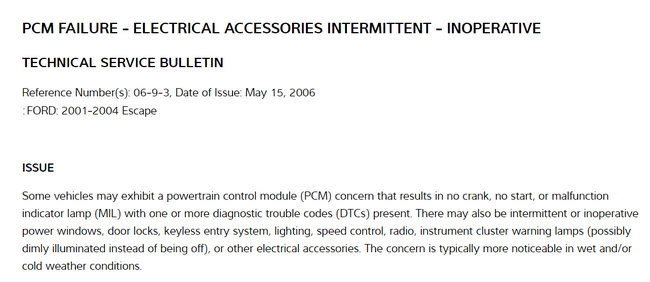

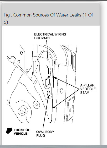

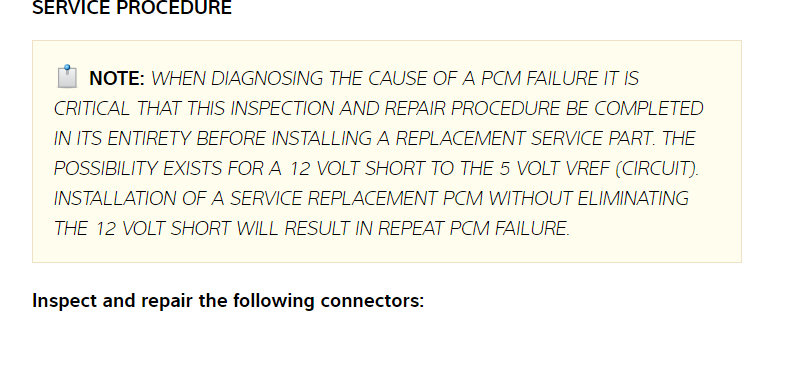

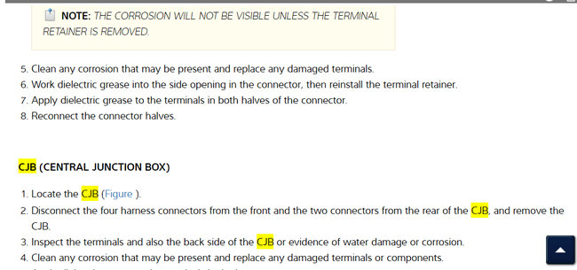

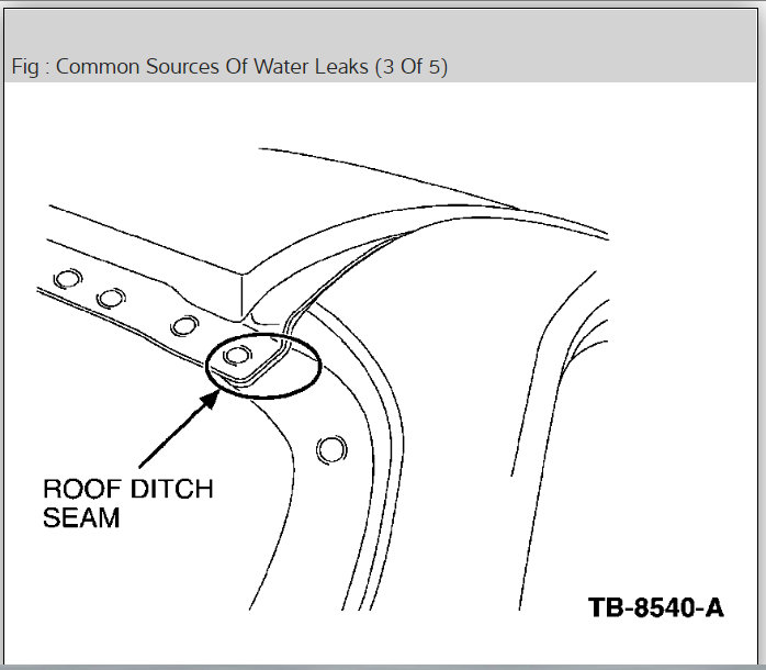

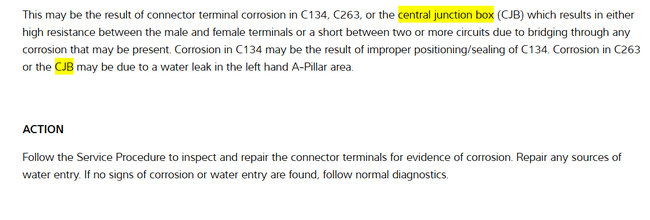

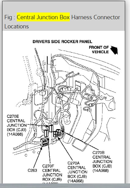

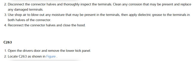

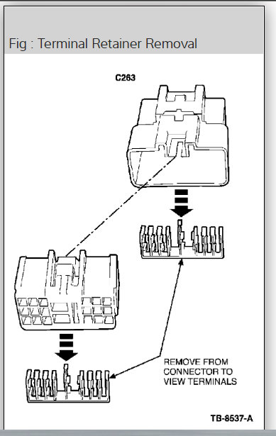

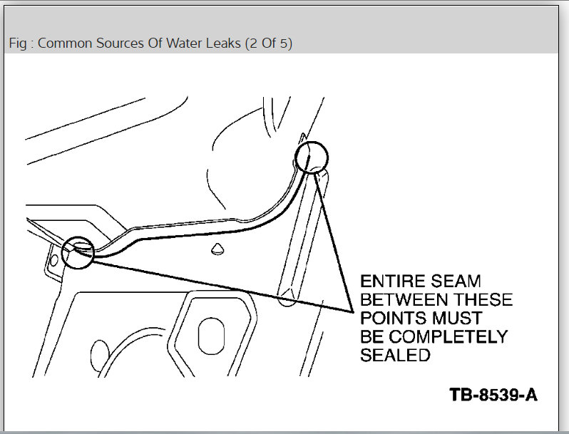

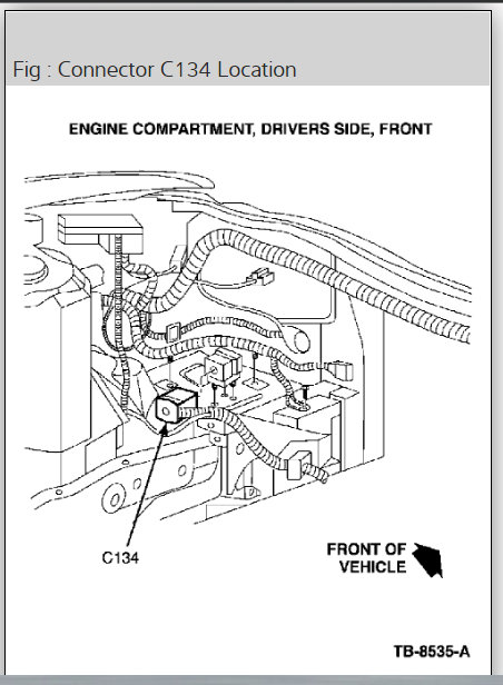

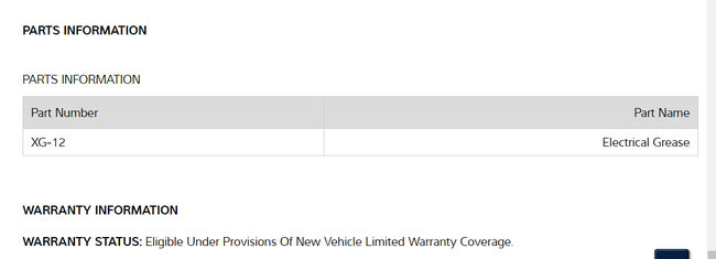

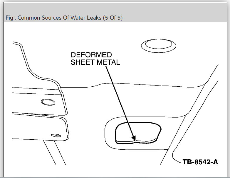

Did you check to see if battery terminals are tight on the battery posts? (+) to (+) and (-) to (-)? Also check your fusible links.I have also included in the diagrams down below a Technical Service Bulletin (TSB) that might interest you. Please go through it and get back to us with what you find out.
This guide can help us fix it
Thanks,
Alex
