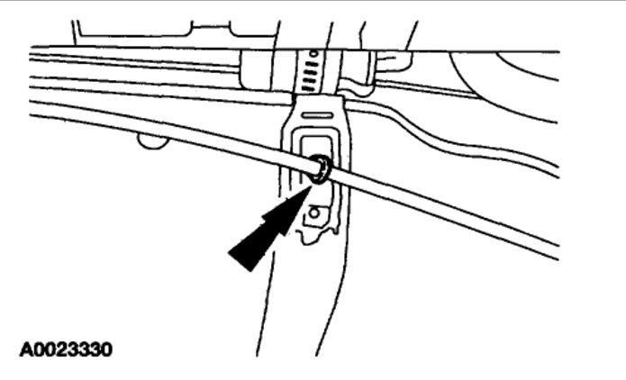

I got my car from my mother who got it from my grandmother who bought it used. The owners manual and both previous owners say if it gets below quarter of a tank it will not start and the fuel pump has to be replaced. My mom says she spoke with the Ford dealership. Supposedly there is no way to fix this and it was made this way. I think the fuel pump shut off switch may have been kicked. Help!

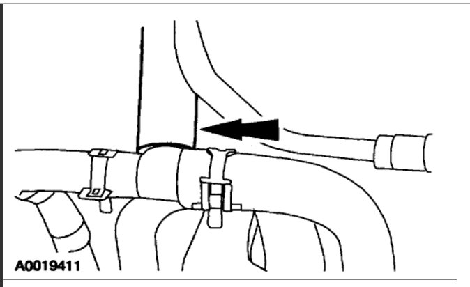

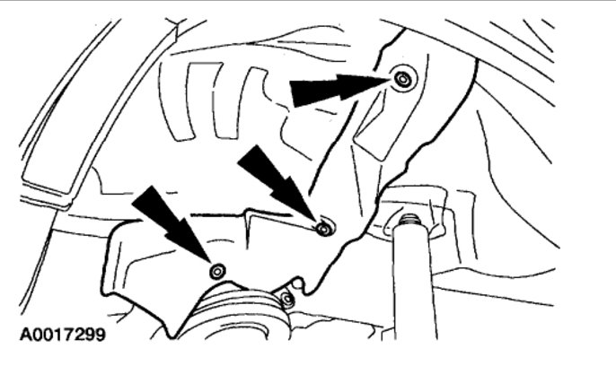

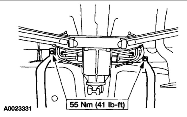

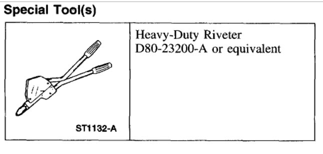

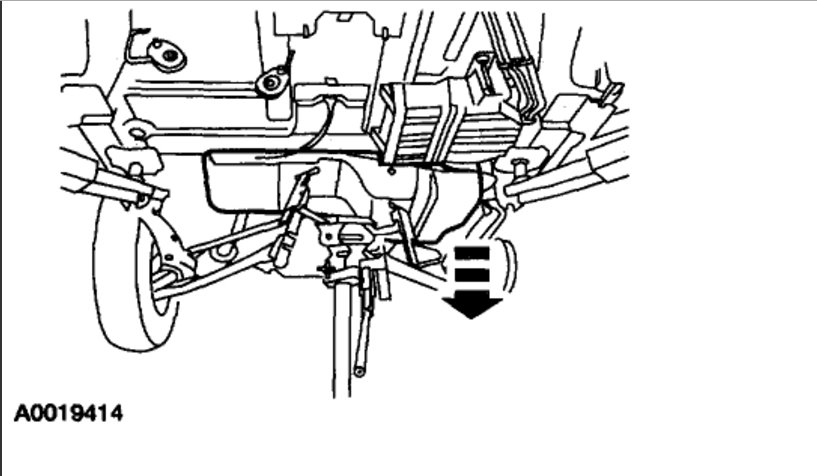

This is a common problem when the fuel pump is starting to go out.
Here is a guide and some diagrams (below) that will show you what is needed to replace the fuel pump:
https://www.2carpros.com/articles/how-to-replace-an-electric-fuel-pump
Here is a video of the job being done on a similar car:
https://youtu.be/D1AyqeftAmA
Here is what you need to do on your car:

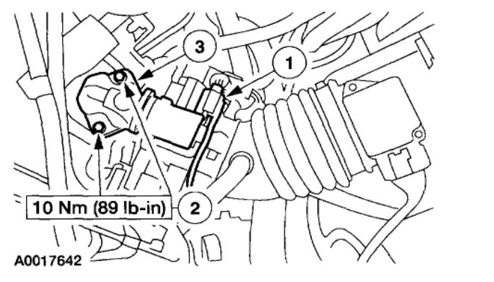

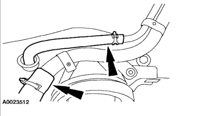

KEN L
  • MASTER CERTIFIED MECHANIC
  • 42,895 POSTS
I have seen this problem before its the idle air control valve making it stall at idle and it is making the noise.
Here is a guide that will help.
https://www.2carpros.com/articles/how-to-replace-an-idle-speed-control-motor-iac

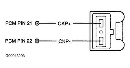

Ok so lets check the crankshaft sensor. The crankshaft sensor is on the front of the engine. What you need to do is unplug it and check the resistance should be 5 ohms or less (do this on the connector, see pic below). Now I need you to use the pic below to check for voltage at the CKP- circuit. To do this with the sensor unpluged hook up you meter to the CKP- term on the plug and turn the key on engine off and check voltage. Should be 1 to 2 volts. Let me know what you find here and we will take it from there.
https://www.2carpros.com/forum/automotive_pictures/249564_Graphic_144.jpg
Wednesday, August 12th, 2020 AT 1:38 PM (Merged)
LARRYE
  • 7 POSTS
I have 1.5 v at the plug but more than 5 ohms on the CKP. On the auto scale I show.356 K ohms, but on the manual scale for just ohms I get no continuity. Am I safe to assume that the CKP sensor is bad? What about the two coils that didn't show any spark? Thanks
-1
LARRYE
  • 7 POSTS
Was the info I provided sufficient or do you need more?
I will be looking often for your reply as I really need to get this car fixed. Please respond as soon as you can. Thanks
Larrye
RACEFAN966
  • 5,029 POSTS
Ok as for the ohms if it is out of spec then yes it should be bad. I am not there so I must assume that the test was done correctly. As for the coils that don't fire this sensor tells the computer when to fire the each cylinder as the crankshaft turns it see's the crank movement (there is a wheel on the crankshaft for it to read) and then the computer fires the coil at the correct time. Now if the crankshaft sensor fails this won't happen so you may get spark at the wrong time or not at all. So with the info given I would say the sensor is bad. Before replacing it I would check the ohms of the new one to the old one because once you plug it in it is non returnable. Let me know how it goes.
