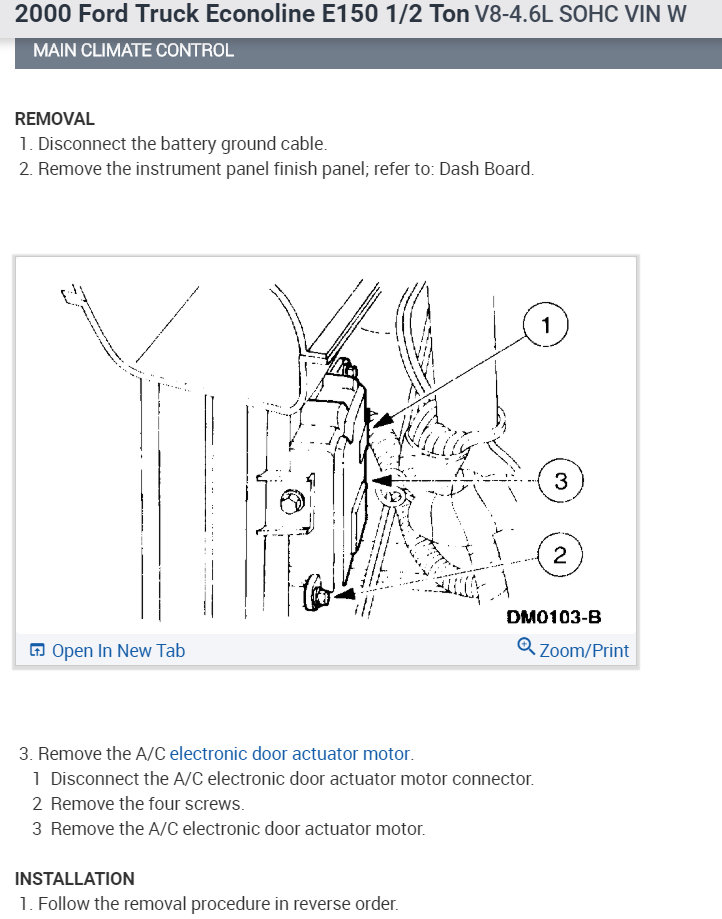

Our van is blowing out hot air only. Air does work - but the temp control that you change from hot to cold is stuck on hot. During the winter I couldn't get the heat to work - now it only blows out hot air.

It sounds like the temperature blend door actuator is not working here is a guide to help walk you through the steps and diagrams below to show you how on your car.
Check out the diagrams (Below). Please let us know what you find. We are interested to see what it is.

Thanks for this post I got a new actuator for $56.00 all fixed I love this site

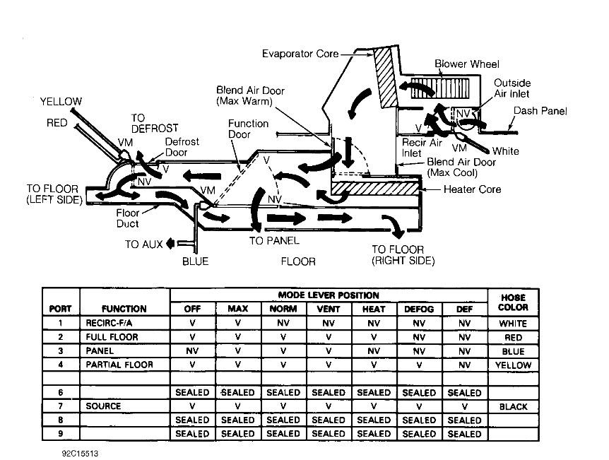

Front A/C vents blow hot air. Rear A/C is ok, cold air.
Wednesday, July 31st, 2019 AT 6:33 PM (Merged)
MERLIN2021
  • 17,250 POSTS
Temperature blend door or heat control valve, if it has one, is stuck, if it's auto temp control do this, hit floor and off at the same tome, then auto this will self test the system, post the code that appears.

5.8 w/ factory rear air, has had new compressor orifice(front), expansion valve (rear) dryer. System was flushed had some metal in orifice but hardly any came out of the system during flush. Both Evaporators looks pretty clean on outside. Charged 65oz as per sticker. Today ambient temp was 91deg and vent temp was 80deg. (About same as before system was serviced, old compressor was leaking though) low pressure was 50 high side was 255. New fan clutch. Removed heater core cover and verified blend door operation. A good friend of mine has a 93 almost identical that will freeze you out what am I missing here.
HMAC300
  • 48,601 POSTS
Is the temp control cable go to a water valve on engine? Is it broken or water valve not working? Is condenser blocked? Is low pressure hose dripping water or frosting over onpipe part? Do you have any vacuum leaks? Is blend door fully closing off heater?

I have 1992 Ford Conversion Van Mark III. It has a rear AC unit that has stickers that it is made by Atwood. It draws Freon off of the front AC compressor which has recently been serviced and blows cold. The rear blower works but will only blow hot air. At the point where the AC lines go in to the unit one is they are cold ( can't remember if one or both) It also has 2 hoses for the heater that are both hot in and out of the unit. I have only found one Vacuum line going near the unit and looks to control the hot water lines going in to the heater core. There is Vacuum there and when the vacuum is removed part of the switch moves but doesn't seem to effect the temp of the air coming out of the rear. Any Diagrams of the Atwood system or insight on how the system works would be greatly appreciated
FREEMBA
  • 1,152 POSTS
The heater valve seems to not be closing completely. Use you hand to push the valve in the direction that it goes when the vacuum is applied (this will fully close the valve). If the air temp changes from hot to cool or cold then the heater control valve is bad.
GOODSKI
Thanks that was what I was leaning toward. It was moving that way when the vacuum was applied didn't cross my mind that it wasn't closing fully. I will check it when I get home.
GOODSKI
Eastcoastautotoys Who bought Atwood some years back they had the part in stock and confirmed that the symptoms pointed to that water valve being the problem. I will follow up when the part arrives and install it
Thanks again for your help.
FREEMBA
  • 1,152 POSTS
You're very welcome Goodski. Let me know how it eventually turns out.
GOODSKI
Yep that was the problem. Haven't driven it for an extended period of time yet but let it Idle for 15 or 20 min and the air didn't heat up which is better than it was doing before. Now I just need to figure out the rough Idle in the van after I let it warm up and the van should be good to go. That will be another question that I pose on a different thread.
