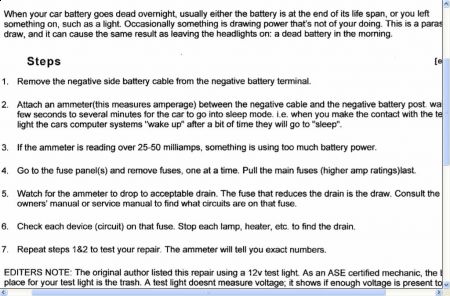

Sounds like you have a short somewhere within the electrical systen eating up the battery overnite. Do the battery drain test below.
https://www.2carpros.com/forum/automotive_pictures/12900_parastic_draw_1_127.jpg

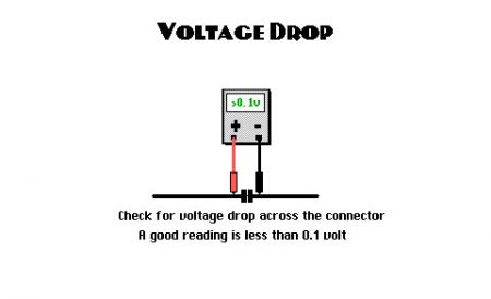

Sorry but how do you do a voltage drop on the battery cables. Please tell me what to do.

VOLTAGE DROP TEST
A voltage drop test is the only effective way to find excessive resistance in high amperage circuits. It's a quick and easy test that doesn't require any disassembly and will quickly show you whether or not you've got a good connection or a bad one.
To do a voltage drop test, you create a load in the circuit that's being tested. Then you use a digital volt meter (DVM) to measure the voltage drop across the live connection while it is under the load. Voltage always follows the path of least resistance, so if the circuit or connection being tested has too much resistance some of the voltage will flow through the DVM and create a voltage reading.
https://www.2carpros.com/forum/automotive_pictures/12900_voltage_drop_2.jpg
If a connection is good, you should find little or no voltage drop and see less than 0.4 volts for most connections, and ideally less than 0.1 volts. But if you find more than a few tenths of a voltage drop across a connection, it indicates excessive resistance and a need for cleaning or repair.

Next, you need to check the negative side of the starter circuit. To check the entire circuit, connect the meter positive lead to a clean spot on the starter motor case and the meter negative lead to the negative battery post. Crank the engine and note the reading. The voltage drop on the negative side should be 0.3 volts or less.
If the voltage drop is too high, set your DVM to the 2 volt scale and start checking each connection on the negative side to find the bad connection or cable. Use the DVM leads to check across each connection while cranking the engine as before.
Check the negative battery post/ground cable connection (should be zero voltage drop).
Check the negative ground cable from the battery to the engine (should be 0.2 volts or less).
Check between the negative battery post and starter housing (should be 0.3 volts or less).
Check between the engine block and starter housing (should be 0.10 volts or less).
