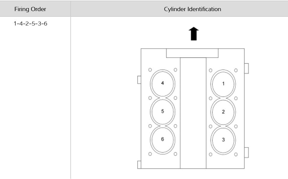

PLEASE SEND ME THE DIAGRAM ON THE FIRING ORDER OF THE SPARK PLUGS

This is for vin U &2
