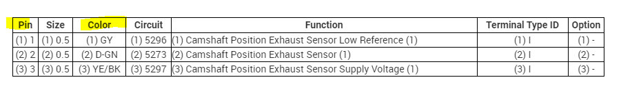

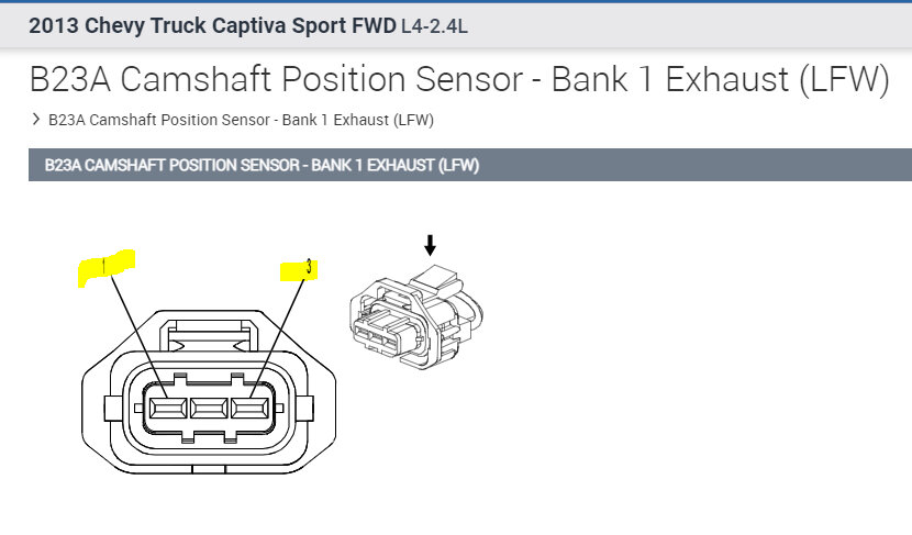

When I was replacing the head gasket the wires to the exhaust cam shaft position sensor pins came out of the plug. I'm having a hard time finding any info on which order I put them back in. I have a green, white, and yellow wire. From the top of the plug (plugged in) what order are they?

Is it possible that the wire you indicate as white is actually gray? I'm not finding anything with those colors for the exhaust cam sensor.
I attached two pics below. The first one shows the connector and identifies the pins as 1 and 3. Pin 2 is the center. The second pic identifies the wire colors, and which pin they go to.
Let me know if this helps.
