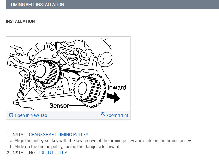

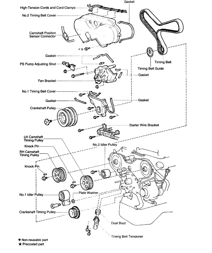

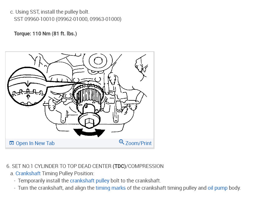

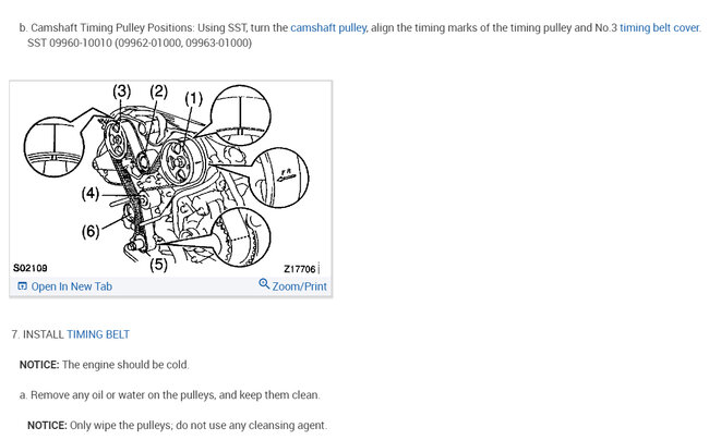

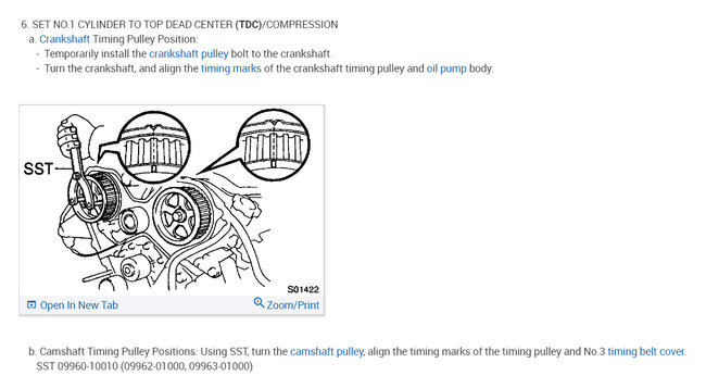

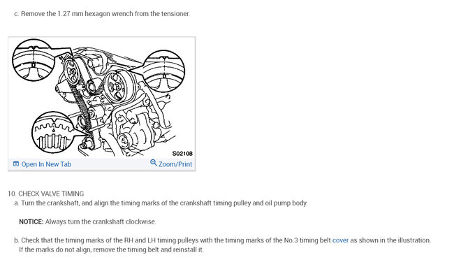

Here is how the timing belt should be installed. If you have the belt on correctly you could have some bent valves causing no compression problems. If you could upload a short video of the problem, I could tell you what the problem is. Check out the images (below). Please let us know what happens.
