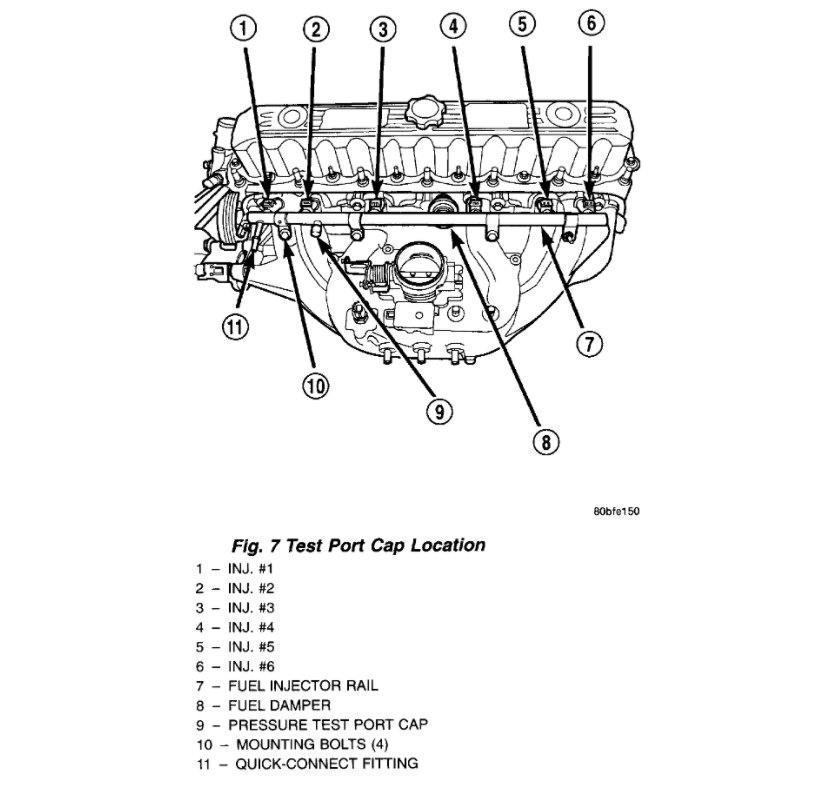

So my vehicle listed above started acting up. When I drove to work a few days ago about 30 miles away my car was fine. But on the way back there was this flapping noise at idle and while driving. When I accelerated my car would start to kick and shake, but when I accelerated quickly it didn’t do it. The check engine light was also flashing. When I got home the codes said it was engine misfire in the second and sixth cylinder. I changed the spark plugs and that didn’t fix it. So I changed the ignition coil and I thought it was fixed, drove fine all around town. When I drove to work it was great but when I drove home the problem came back. I shut the car off and turned it back on, it was a very hard start. It was also idling really rough and almost stalled out. I turned the car back on and kept going and the problem went away. I also noticed that when I start my car and I hear the flapping the problem will come back, but I can shut my car off and start it again and the noise usually goes away. Any ideas what it could be? Please help.

Good evening,
Can you upload a video of the noise so I can hear it?
Was the 302 and 306 the only codes that was set? I would check the compression in all cylinders to be sure there is not an internal issue.
Also, check the fuel pressure as low fuel pressure will cause misfire codes from the lack of fuel to the rail.
