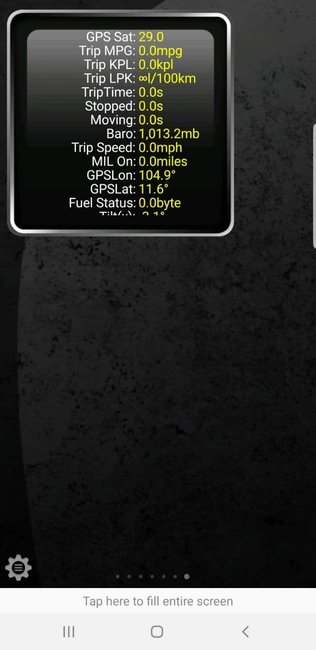

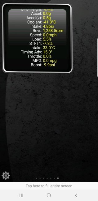

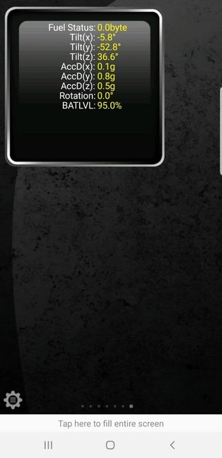

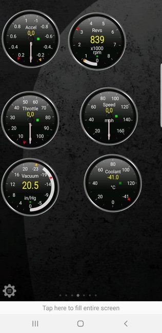

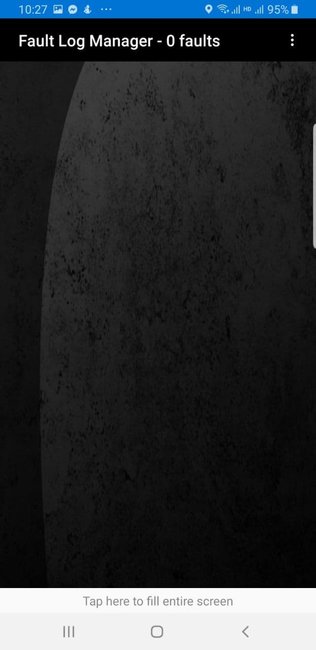

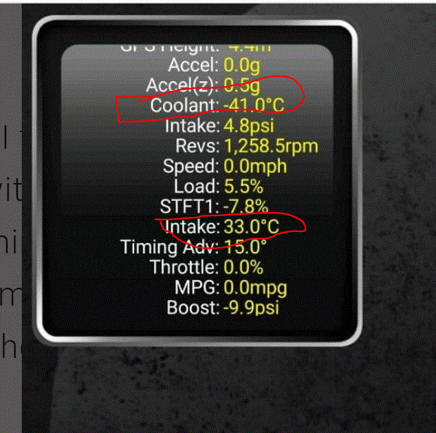

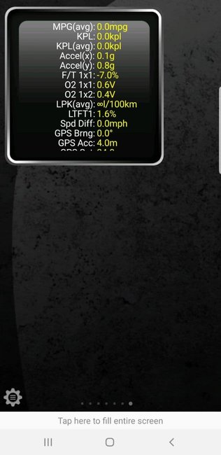

Hi, Mr. Joe, I have a mini scan tool and I try to check this is what I get. But actually I have test with idling my car with no air con turn on and wait if the engine fan running and yes the fan running as normal. So i thought may be the coolant temperature might be working normal but my scan tool not support with my car. Scan tool and result attach in photos.
Sothy.

I attached a copy of one of your pics below and circled two temperatures.
Was it -41° Celsius? Also, it shows 33°Celcius is the temperature of the air entering the engine. That is a really big difference.
Let me know if it was actually that cold when you checked this.

Hi, Mr. Joe. Thank you.
Actually here is 27-29 C, and I don't know why it doesn't change the temp, it is stuck at -41C even if try idling for about 10mn. And wait until the engine fan running as normal.

That is the likely problem. It is telling the computer it is -41°C and the computer is making the fuel mixture extremely rich so the engine can run under those extreme conditions. Basically, the engine is getting too much gas because it thinks it is that cold.
Replace the sensor and let me know if that takes care of the problem.

I just change the Coolant Temperature Sensor yesterday and now the problem is gone. Thank you so much for your help.

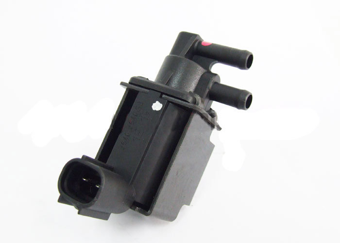

Can I ask you little out of topics? I just wonder what is purge control valve or solenoid use for? I just found out that my car was plug in the wrong tube for many years.

As far as the purge valve, it is a component of your Evaporative Emission Control (EVAP) system. This system restricts the fuel vapor in the fuel tank from escaping into the atmosphere. Basically, it allows the vapors to be stored in what is called a charcoal canister to be burned by the engine when it is actuated to do so.

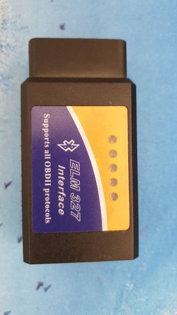

The problem seem to come again after few days, The same problem just came up yesterday and the characteristic is the same but fuel consumption back to normal. what should I do or check again thank you for your help. Oh anyway I just found out that my obd2 Bluetooth not fully supported it say I need version 1.0 obd2 and what I have is 2.1 obd2.
