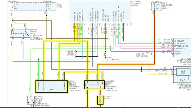

The heater fan will occasionally turn on with ignition switch in off position running the battery dead. Sometimes the fan will keep running when the ignition switch is turned off.
May 2, 2020 at 1:50 PM
  • CAR REPAIR CONTRIBUTOR
Good evening,

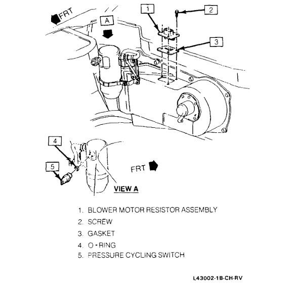

The most common cause for this issue is the blower motor resistor. It shorts to power and the blower will not stop running, even with the key off.
I attached the location and procedure for you along with a wiring diagram.
