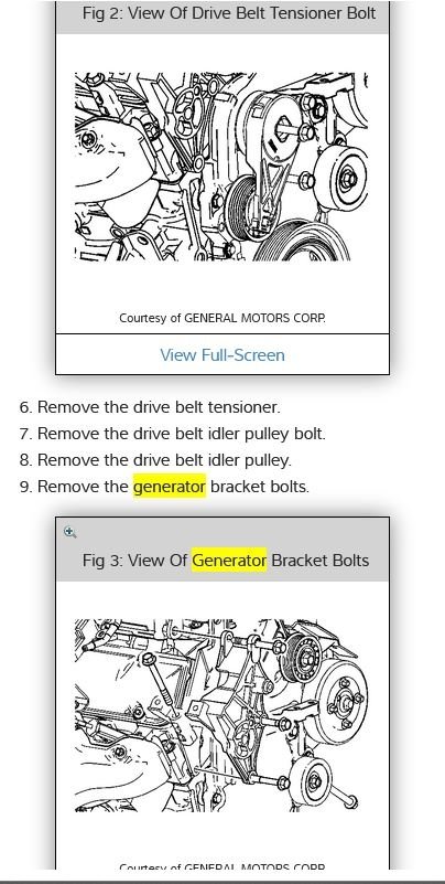

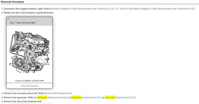

See diagrams below for removal.

Here is a guide that will walk you through the steps:
