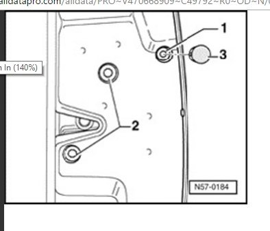

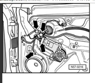

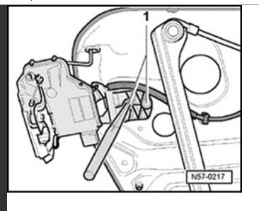

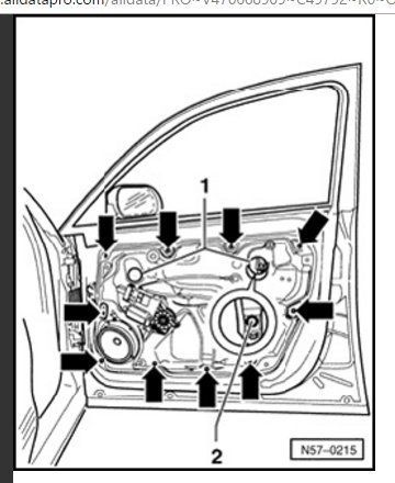

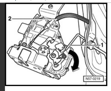

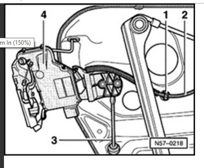

I have the left rear door and i cannot open it from inside or outside. I started to take out the cover, i reached the actuator, when i am pressing the button from the key i can hear a noise in the actuator, but does not want to open at all. I need some ideas. Thanks!

Is there a chance the lock is engaged due to the lock rod loose/missing/fallen off?
Here are some diagrams that may help you.

Hello fellows! Today I sprayed the amazing WD40 allover the mechanism , I pulled out the door seal and I applied some spray there close to the latch. After I pulled the wire for the first time the door opened. Job done without any cost, everything is in good working condition now.Thank you all!
