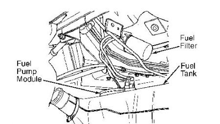

Where is the fuel filter located

Fuel filter is located on the frame, above rear of fuel tank. Fuel tank must be lowered for access to fuel filter. Fuel lines are permanently attached to fuel filter.
http://www.2carpros.com/forum/automotive_pictures/261618_Noname_55.jpg
Need removal and installation instructions? Just ask and you shall receive.
