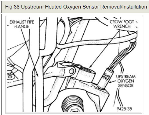

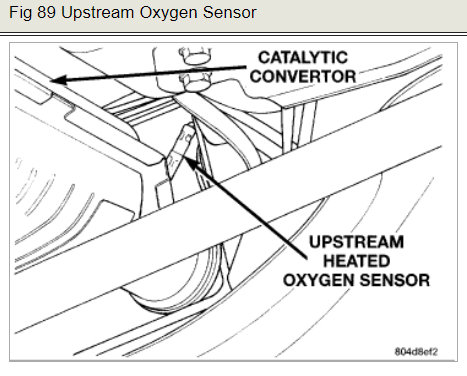

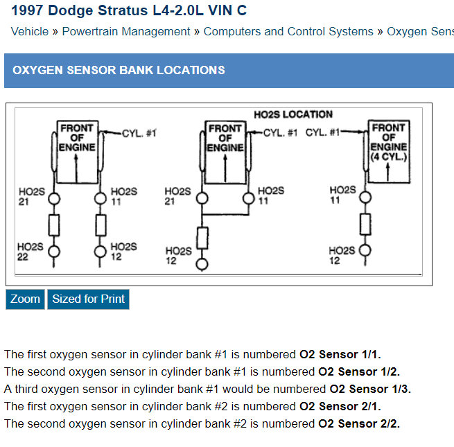

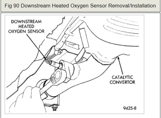

Here is a guide and the locations of your oxygen sensors and a guide to help you get them changed out. Check you fuses first.
https://www.2carpros.com/articles/how-to-replace-an-oxygen-sensor
Here are the sensor locations. Check out the diagrams (Below)

I believe that is the sensor after the converter, if that is what that is before it. if that the catalytic converter, that is bank 1 sensor TWO. the 1st sensor should be on the exhaust manifold BEFORE the converter.
Here is a guide
Cheers

BMRFIXIT
  • 19,053 POSTS
You have two
before and after the catalytic converter
which one did you replace
# 1 is before and # 2 is after the converter
Simple and Easy

Check in the exhaust manifold have # 1 oxygen sensor
+1
Thursday, December 3rd, 2020 AT 10:31 AM (Merged)
BMRFIXIT
  • 19,053 POSTS
https://www.2carpros.com/forum/automotive_pictures/99387_O2_1.jpg
+4
LINKINXP
  • 11 POSTS
Cool! Thanks so that one has 4 cables right? Cause I saw another one! Near that and it had 2 cables. Thanks for the picture. And that one is Upstream? Im sure!
