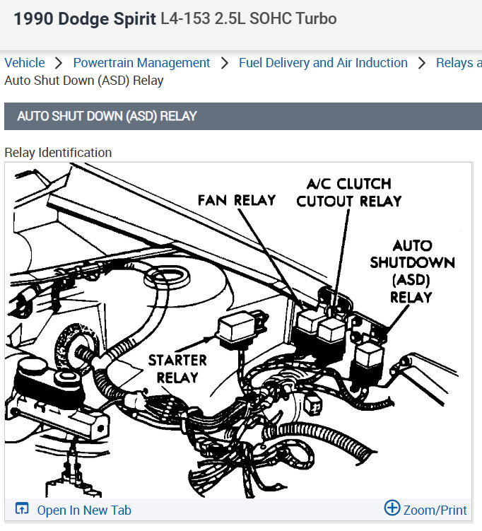

where is the fuel pump relay located on a 1990 dodge spirit please

There's no fuel pump relay, Its the ASD relay that powers the fuel pump-See below for location and TY for using 2carpros
https://images.2carpros.com/forum/automotive_pictures/12900_asd_relay_7.jpg

I asked for a picture of the fuel pump relay there's no picture?

The ASD relay is the fuel pump relay. Check out the images (below).
