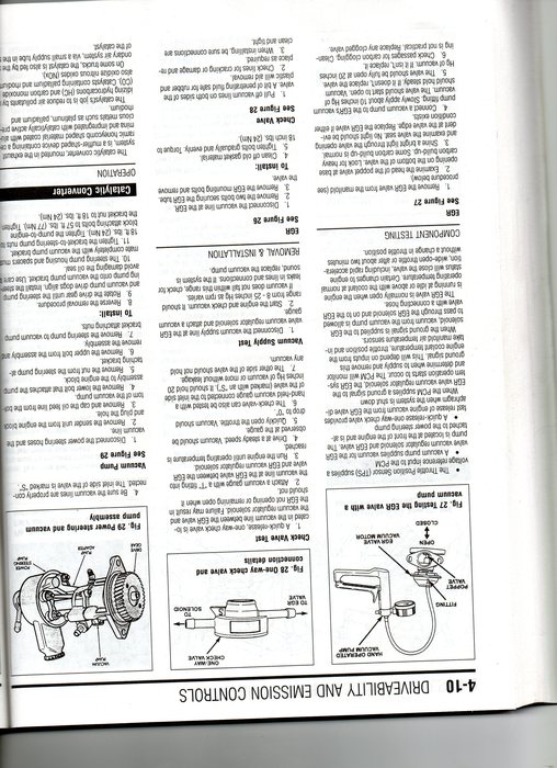

Where is the egr valve?

Maybe this will help
