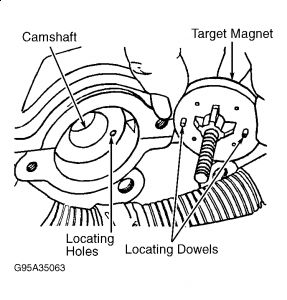

I just went in to have a Cam Shaft Sensor replaced on my car and I checked to see if the code came back up and it did. 0340. I just paid over $100 to find out there may be something else. If this part replacement isn't it, what could cause the code to come back up? A set of "wires" of some sort, I believe the mechanic called it the connector (?), Came in the box and I was asked if I wanted to install that as well and that the old connector looked fine for now so I didn't have him install the new one. I didn't have the time or the extra money to have this done. I fear this was a bad decision.
Should I be concerned? If this did fix things, is there a way to reset the code so I won't see it again if I check for it or am I just screwed? Thanks in advance for your time and answer.

P0340
http://www.2carpros.com/forum/automotive_pictures/99387_Graphic1_279.jpg
http://www.2carpros.com/forum/automotive_pictures/99387_Graphic3_62.jpg
http://www.2carpros.com/forum/automotive_pictures/99387_Graphic2_127.jpg
Cam signal is monitored during engine cranking after a specified number of crankshaft position sensor signals have been detected. DTC may be stored in Powertrain Control Module (PCM) when no signal is received from Camshaft Position (CMP) sensor when crankshaft position sensor signal exists. Possible causes are: engine does not start, defective camshaft position sensor or target magnet, defective PCM, or defective connectors or wiring.
DTC P0340: NO CAM SIGNAL AT PCM
1.Turn ignition on with engine off. Using scan tool, check for DTCs. If global good trip counter is displayed and equal to zero, go to next step. If global good trip counter is not displayed and equal to zero, go to step 12 .
2.Turn ignition off. Disconnect connector at camshaft position sensor. Camshaft position sensor is located on rear of cylinder head, just below valve cover. connector for corroded, pushed out, miswired or damaged terminals. If terminals are not corroded, pushed out, miswired or damaged, go to next step. If terminals are corroded, pushed out, miswired or damaged, repair as necessary. Perform TEST VER-5A .
3.Turn ignition on with engine off. Using voltmeter, check voltage at terminal No. 1 (Orange wire) on connector for camshaft position sensor. If voltage is more than 7 volts, go to next step. If voltage is 7 volts or less, repair open circuit on Orange wire between camshaft position sensor and PCM. PCM is located at driver's side front corner of engine compartment, between battery and fender. Perform TEST VER-5A .
4.Using ohmmeter, check resistance between ground and terminal No. 2 (Black/Light Blue wire) on connector for camshaft position sensor. If resistance is less than 5 ohms, go to next step. If resistance is 5 ohms or more, repair open circuit on Black/Light Blue wire between PCM and camshaft position sensor. PCM is located at driver's side front corner of engine compartment, between battery and fender. Perform TEST VER-5A .
5.Turn ignition on with engine off. Using scan tool, monitor Camshaft Position (CMP) sensor state while momentarily connecting jumper wire between terminals No. 2 (Black/Light Blue wire) and No. 3 (Tan/Yellow wire) on connector for camshaft position sensor. If CMP sensor state changes, go to next step. If CMP sensor state does not change, go to step 7 .
6.Turn ignition off. Remove camshaft position sensor from cylinder head. Inspect target magnet and locating dowels for damage or misalignment. Replace target magnet and locating dowels if damaged or misaligned. Perform TEST VER-5A . If target magnet and locating dowels are okay, replace camshaft position sensor.
