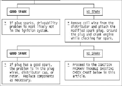

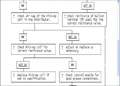

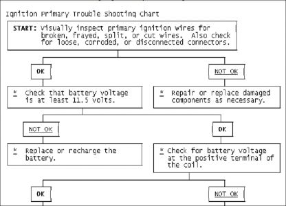

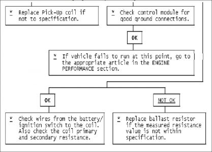

Since you don't have a spark at the plugs....I have attached the troubleshooting chart for this. I had to overlap to make it big enough for you to see.
http://www.2carpros.com/forum/automotive_pictures/248015_2_109.jpg
http://www.2carpros.com/forum/automotive_pictures/248015_3_76.jpg
http://www.2carpros.com/forum/automotive_pictures/248015_4_50.jpg
http://www.2carpros.com/forum/automotive_pictures/248015_5_33.jpg
There was also a tip attached to this to keep in mind.
Some vehicles may exhibit a no spark or weak spark condition. This could be caused by low voltage output from the Intelligent Power Distribution Module(IPDM).Check voltage at the white/blue wire at any of the individual coil connectors. Battery voltage should be available. A one volt drop or greater could cause a no spark/weak spark condition. Jump battery power with a fused jumper to white/blue wire and attempt to start engine, if engine starts, replace IPDM. It is a fairly inexpensive part and easily replaced.
