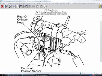

How hard is it to change out the camshaft sensor? Where is it located. Also I have a door fuse light on on the odometer. Where is the fuse?

Removal & Installation (Neon) 1. Camshaft Position (CMP) Sensor is located on rear of cylinder head. See Fig. 50 . Remove brake booster hose and harness connectors from valve cover and reposition. 2. Disconnect CMP sensor harness connector. Remove CMP sensor mounting screws. Remove CMP sensor. Loosen retaining bolt and remove target magnet mounted to rear of camshaft. 3. To install, line up target magnet with locating dowels in end of camshaft and install retaining bolt. Tighten target magnet retaining bolt to specification. See TORQUE SPECIFICATIONS . 4. Install CMP sensor and tighten mounting screws to specification. See TORQUE SPECIFICATIONS . To complete installation, reverse removal procedure. Fig. 50: Locating Camshaft Position Sensor (Neon) Courtesy of DAIMLERCHRYSLER CORPORATION Page 1 of 1 REMOVAL, OVERHAUL & INSTALLATION - CARS -2001 Dodge Neon ES 7/31/2008 Fuses are shown here:
