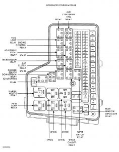

5.Turn ignition switch to LOCK position. Disconnect solenoid/TRS assembly harness connector. Turn ignition on. Connect test light between ground and transmission control relay output circuit at solenoid/TRS assembly harness connector terminal No. 10. See WIRING DIAGRAMS . If test light illuminates brightly, remove test light and go to next step. If test light does not illuminate brightly, repair open or high resistance in circuit. If fuse is open, ensure to check for a short to ground.
6.Turn ignition switch to LOCK position. Disconnect TCM harness connector. Measure resistance of UD pressure switch sense circuit between TCM harness connector terminal No. 29 and solenoid/TRS assembly harness connector terminal No. 18. If resistance is greater than 5 ohms, repair open circuit. If resistance is 5 ohms or less, go to next step.
7.Measure resistance between ground and UD pressure switch sense circuit at solenoid/TRS assembly harness connector terminal No. 18. If resistance is less than 5 ohms, repair circuit for short to ground. If resistance is 5 ohms or greater, go to next step.

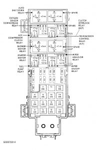

8.Remove transmission control relay from Integrated Power Module (IPM) or Power Distribution Center (PDC). Using fused jumper wire, jumper fused B+ circuit (terminal No. 30) and transmission control relay output circuit (terminal No. 87) together at transmission control relay connector. See WIRING DIAGRAMS . Turn ignition on. Measure voltage of UD pressure switch sense circuit at TCM harness connector terminal No. 29. If voltage is greater than .5 volt, repair circuit for short to voltage. If voltage is .5 volt or less, and go to next step.
9.If no other potential causes for DTC P0876 remain, TCM is assumed to be faulty. Repair or replace as necessary. See TRANSMISSION CONTROL MODULE under REMOVAL & INSTALLATION.
