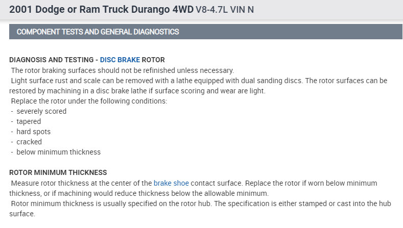

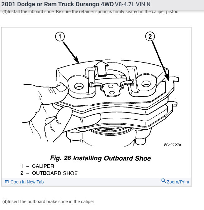

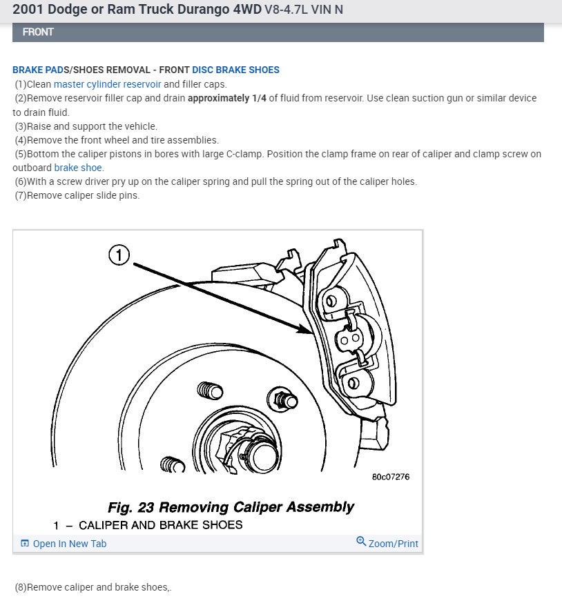

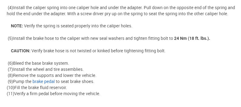

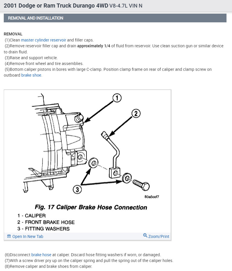

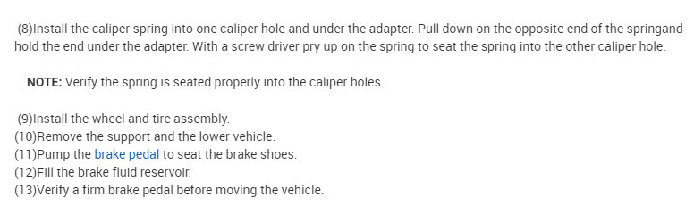

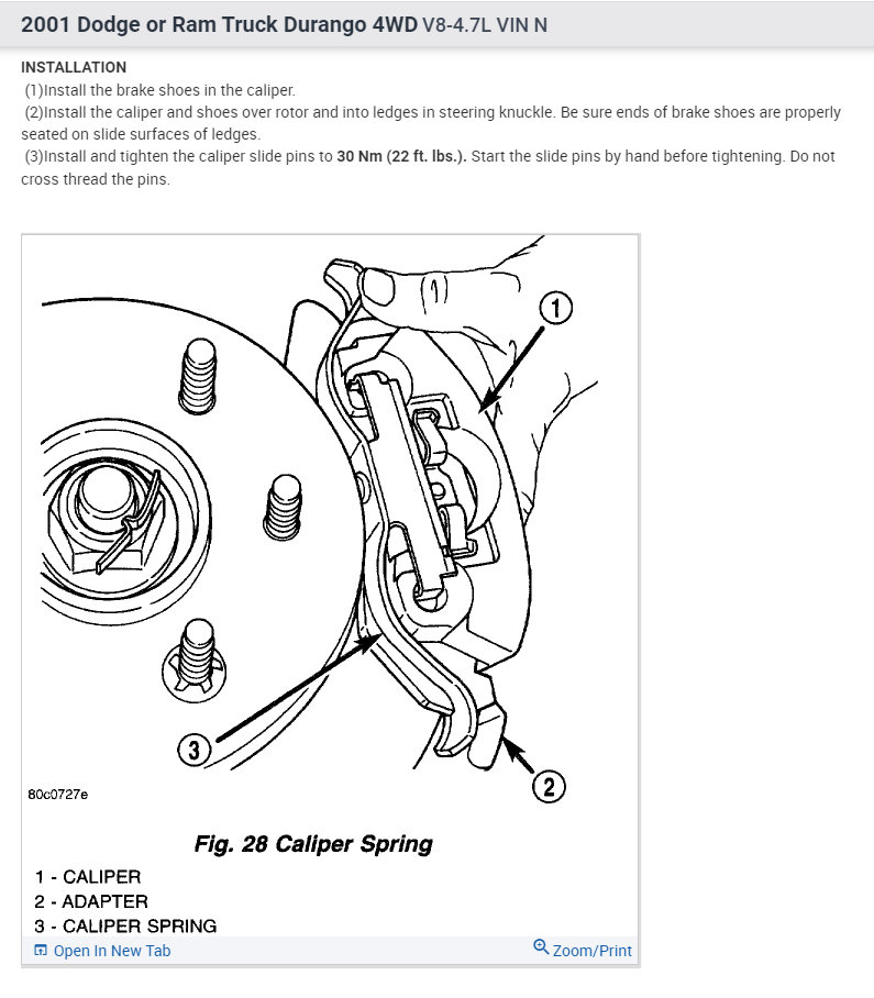

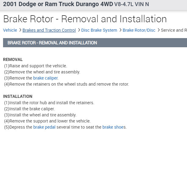

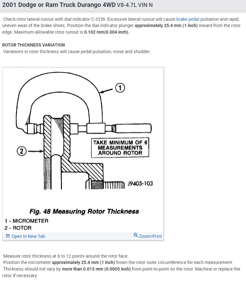

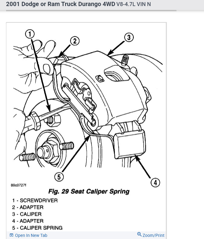

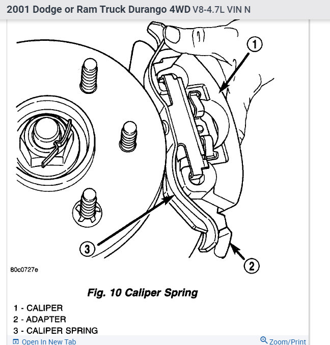

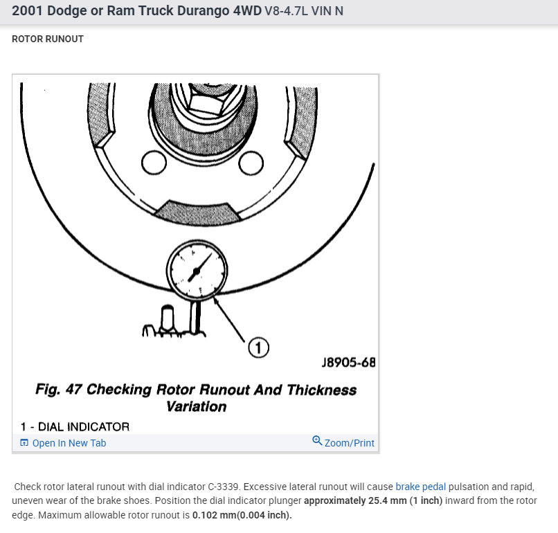

do I need any special tools to remove the front rotors on on my 2001 durango (all wheel drive) or is it just the lug nuts that hold it on. should I use a puller? What is the process?
Thanks!
Jun 22, 2009 at 1:06 PM
SQM
  • CAR REPAIR CONTRIBUTOR
  • 6,383 POSTS

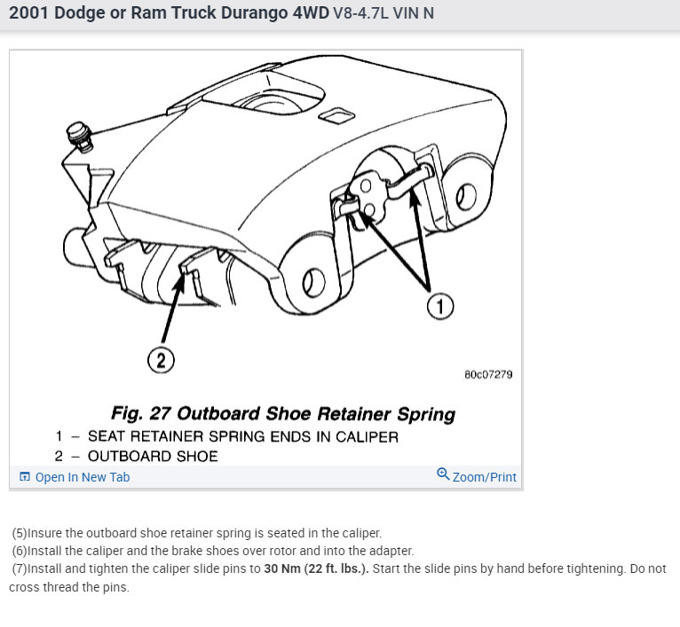

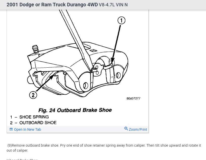

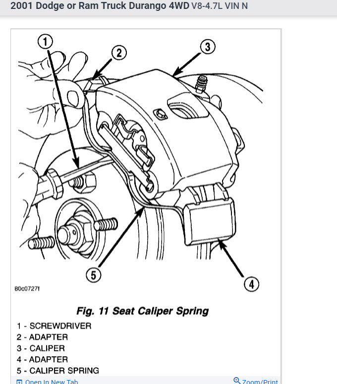

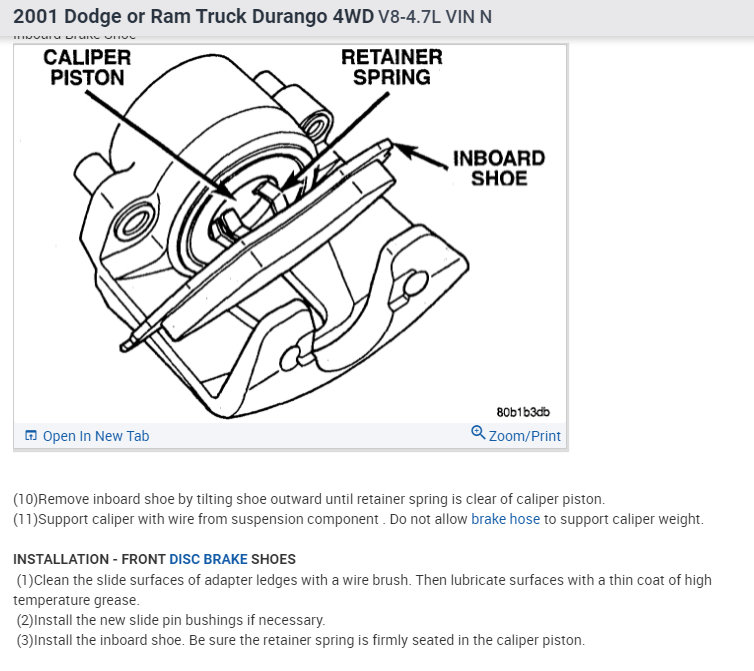

The brake rotors and pads can be replaced using basic hand tools.
After the wheel is removed, you will have to remove the caliper and the center retainer.
Here is a helpful guide:
I have attached the replacement procedures below.
